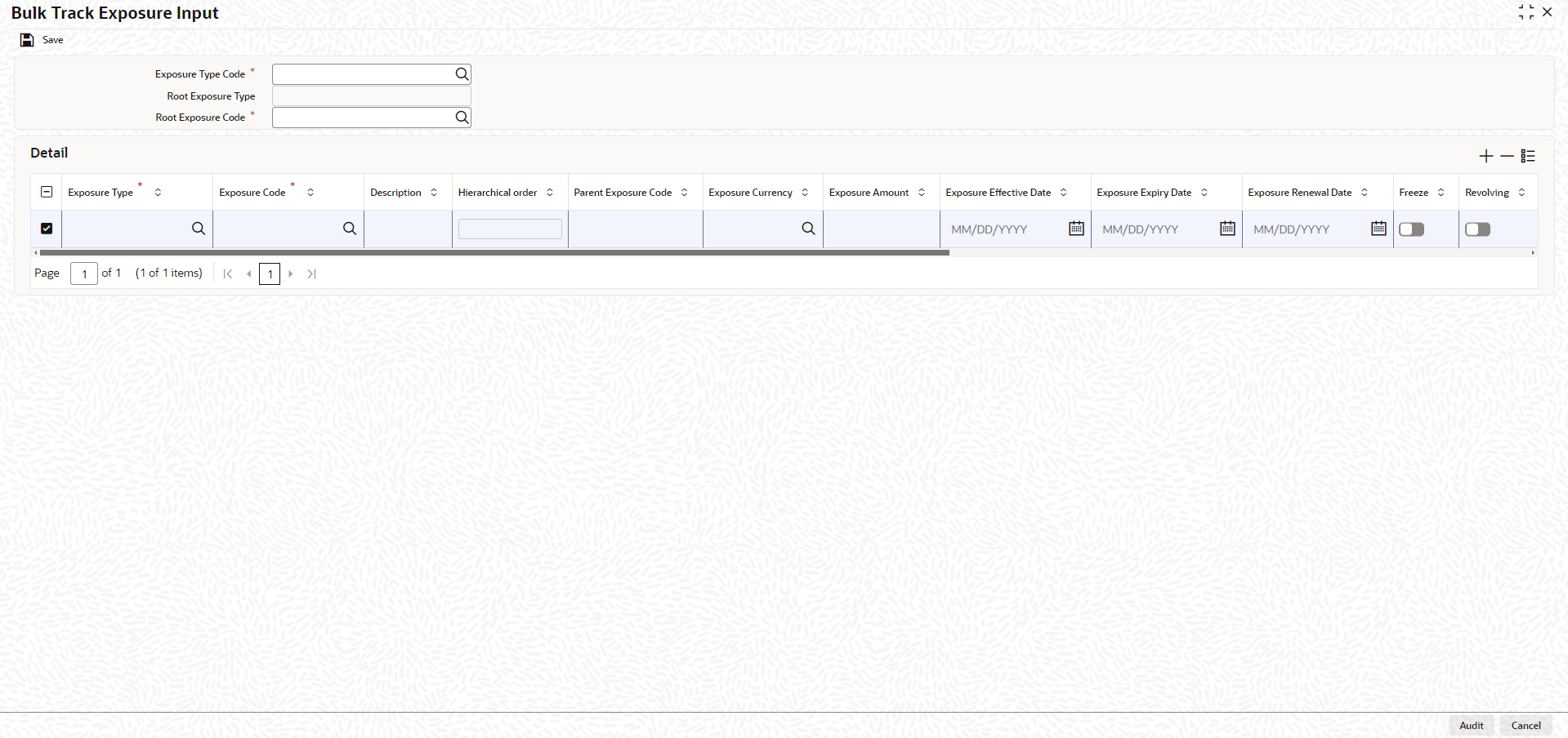

  1. On the Home screen, specify GEDBTEXP in the text box and click the Next icon.
    Figure 2-56 Bulk Track Exposure Input
  2. On Bulk Track Exposure Input screen, click New and specify the fields.
    Table 2-58 Bulk Track Exposure Input - Field Description
    Field Description
    Exposure Type Code Click the Search icon and select the required exposure type code from the list. The exposure type codes maintained in the Exposure Type Maintenance screen () are displayed.
    Root Exposure Type This field will be automatically displayed based on the type code selected.
    Root Exposure Code Click the Search icon and select the required root exposure code from the list. The top most exposure codes in the hierarchy maintained in as attribute value are displayed in the drop-down list.
    By default, hierarchical order 1 will be assigned to the Root Exposure Code. You can create exposure codes upto 9 level of hierarchy in this screen.
    Detail For more information on detail, refer Track Exposure Maintenance (GEDTREXP).
  3. Click Save to save the record.
