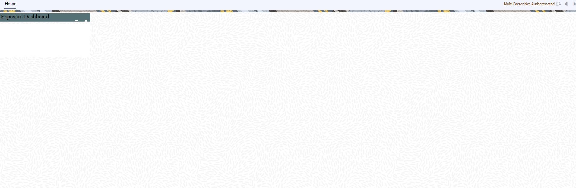

- On the Home screen, specify
GEDEXDBD in the text box and click the
icon.For more information on fields, refer to the field description table.Table 2-59 Exposure Dashboard - Field Description
