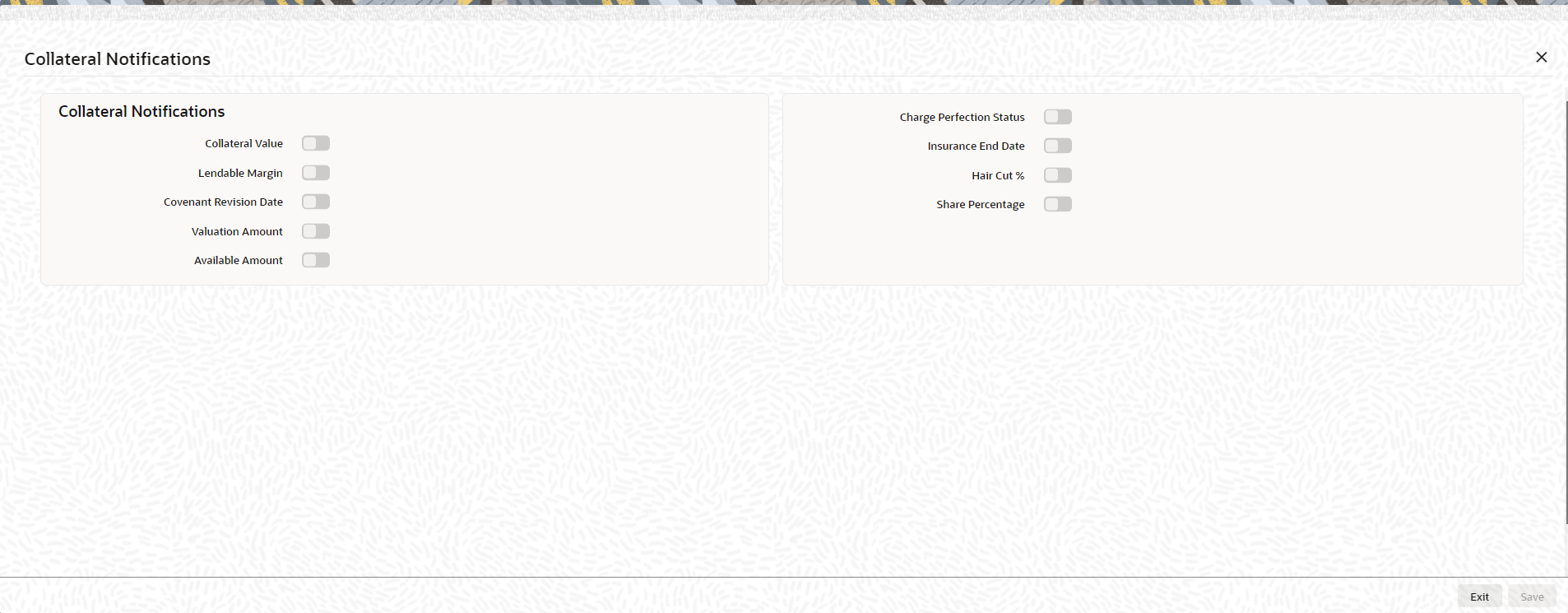

- On Collaterals Maintenance screen, click the
Notifications tab.The Collateral Notifications screen is displayed.
Table 2-38 Notifications
Field name Screen Modification Old value relevance Notification triggered when Collateral Value Main screen Direct/Batch Yes Collateral value changes. Lendable Margin Main screen Direct/Batch Yes Lendable margin changes because of revaluation on account of change in haircut or on changing the Haircut % directly. Covenant Revision Date Covenants screen Batch No Revision date is crossed and covenant expires. Valuation Amount Valuation screen Direct Yes Valuation amount changes. Haircut % Main screen Direct/Batch Yes Haircut percentage changed directly or based on haircut schedule or linked haircut code rate is modified resulting in haircut% in turn lendable margin. Charge Perfection Status Perfection screen Batch No Charge status is expired. Insurance End Date Insurance screen Batch No Whenever collateral is modified as part of EOD or manual screen update and Insurance end date is less than or equal to current date. Available Amount Main screen Direct/Batch Yes Available amount changes. Notification sub-system enables the particular collateral record to be a candidate for notification when the record is created / amended. At least one of the out of box supplied fields in notification sub-system must be enabled to bring this collateral under the purview of generating notification. When values in fields enabled for notification are modified as part of direct update process or as part of batch update process, all the details of the collateral are sent in the notification message along with old and new value details of the fields enabled for notification.
