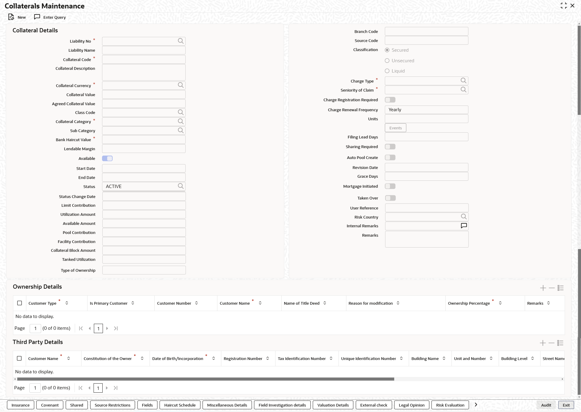

2.11 Collaterals Maintenance
This topic provides information on collaterals maintenance.
The fields, which are marked with an asterisk, are mandatory.In the Collaterals Maintenance screen, you can maintain the details of collateral offered by customers for the credit that the bank grants under a credit line. The collateral can either be market value based or non market value based.
- On the Home screen, specify
GCDCOLLT in the text box and click the
icon.The Collaterals Maintenance screen is displayed. - On Collaterals Maintenance screen, click
New and specify the fields.For more information on fields, refer to the field description table.If it is Market value based then the collateral value is calculated as shown in the following examples.
