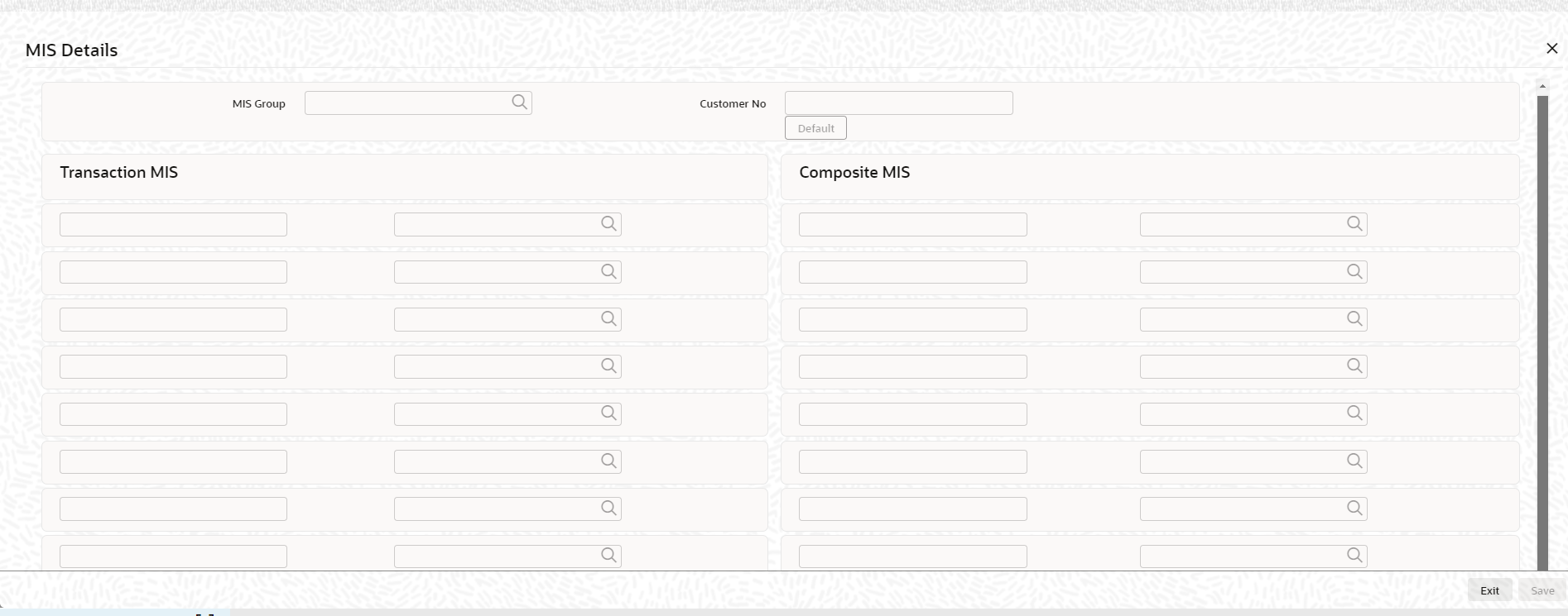

  1. On Collaterals Maintenance screen, click the MIS Class tab.
    The MIS Details screen is displayed. For more information on fields, refer to the field description table.

    MIS Group This field gets defaulted based on fee class selection or select the MIS group from the list of groups configured in MIDGRPMT screen.
    Default Click this button to fetch the composite MIS codes maintained for the customer in STDCIF screen, if there is only one customer explicitly selected at the collateral level or if there is only one customer linked to the liability.
    The user must click this button each time they make changes to the liability. Thus the system can fetch and default the updated composite MIS.
    Customer No Displays the customer number for which the composite MIS are fetched from STDCIF screen. Composite MIS codes will be fetched from STDCIF screen, if the ELCM is integrated with ROFC (external system).
    Transaction MIS Displays the transaction type of MIS code based on the selected MIS Group or the Transaction MIS code associated with the fee class.
    Composite MIS Displays the Composite type of MIS code based on the selected MIS Group or the Composite MIS code associated with the fee class.
    MIS Code Transaction and Composite MIS codes configured in GLDCLSMT or MIDGRPMT screen are auto-populated based on the selected MIS Group or fee class. The user can also add, modify or delete the MIS codes of type Transaction and Composite.
    Note: MIS Codes of Customer and Fund Types will not be populated in the MIS Class sub-screen and the same cannot be used for collateral maintenance.
    MIS Class Displays the MIS class based on the selected MIS code.
