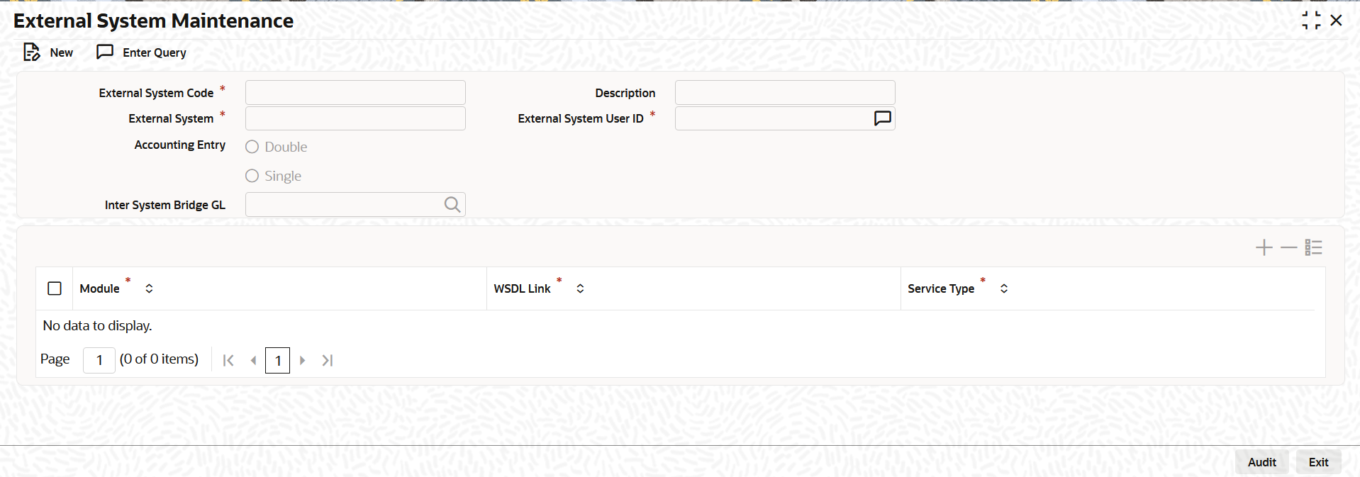

2.3.3 External System Maintanance
This topic describes about the External System Maintanance.
- On the Home screen, specify GEDEXMNT in the text box and
click the
icon.The External System Maintanance screen is displayed. - On External System Maintanance screen, specify the
fields.For more information on fields, refer to the field description table.The following table indicates the maintenance required for ROFC interface.
Table 2-3 External System Maintanance Fields and Description
Field Description External System Code A unique code for maintaining external system details, that is for WSDL URL. For example, external system code for OBCL is OBCL, for FCUBS it is ROFC. Description This field is optional. It describes about external system code. For example, if you have multiple ROFCs you can differentiate in description. External System Indicates external system class. You can either select ‘FCUBS’ or ‘Others’ from the dropdown list. External System User ID Indicates the user ID used for login. Module ID Indicates the module code used for external system. For example, TD, ST, OL, MM, and so on. WSDL Link Indicates the link to access the web service. Table 2-4 ROFC interface
External System Module Description ROFC CASA Service to be invoked in ROFC during facility modification. ROFC OVD Service to be invoked in case of deferred override response or dua-auth response. ROFC OB Sice to be invoked to send guarantee collateral details. ROFC LC Service to send LC collateral linkage details ROFC TD Service to block TD ROFC CD Service to block CD The following table indicates the maintenance required for OBCL interface.
Table 2-5 OBCL interface
External System Module Description OBCL OVD Service to be invoked in case of deferred override response or dual-auth response.
