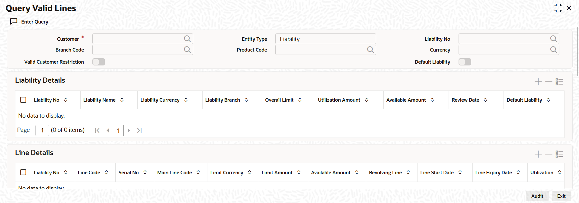

  1. On the Home screen, specify GEDQVLLN in the text box and click the Go icon icon.
    The Query Valid Lines screen is displayed.
  2. On Query valid line screen, specify the fields.
    Table 2-2 Query Valid Lines Fields and Description
    Field Description
    Customer Specify the customer code. The adjoining option list displays all the valid customer codes. You can select the appropriate one.
    Entity Type Obligation, system fetches details of collaterals of obligation type wherein customer given is the guarantor CIF.
    Liability No Select the Liability Number. You can query the valid lines on the basis of Customer no or/and Liability no.
    Default liability When a customer is linked to multiple liabilities by checking default liability, system fetches details of selected entity type/ALL entities belonging to the liability with which customer is having default linkage.
    When default liability is unchecked, system fetches details of selected entity type/ALL entities belonging to the liability to which customer is linked and selected against the liability number. When no liability number is selected, system fetches details of selected entity type/ALL entities belonging to all the liabilities to which customer is linked.
    All the details of the Customer no or/and Liability no can be viewed in the Limit Type sections.
