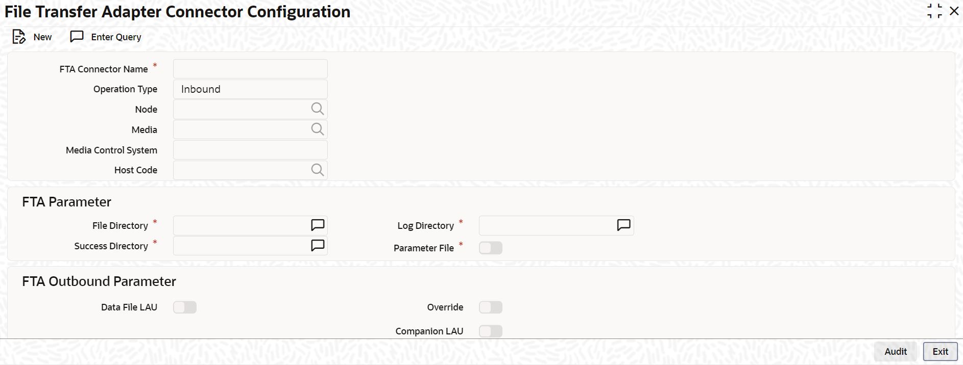

This topic explains systematic instructions to maintain the File Transfer Adapter Connector Configuration screen.
The fields which are marked in asterisk are mandatory.- On Homescreen, type MSDFTACN in the text box, and click Next.The File Transfer Adapter Connector Configuration screen displays.
Figure 1-21 File Transfer Adapter Connector Configuration
- On the File Transfer Adapter Connector Configuration screen, specify the fields.
Table 1-23 File Transfer Adapter Connector Configuration - Field Description
Field Description FTA Connector Name Specify the FTA Connector Name. Operation Type Select the type of operation from the drop-down list: - Inbound
- Outbound
Host Code Specify the Host Code. Data file LAU Check this box if FCM calculates the LAU of the data file and puts the calculated value in the parameter file. Companion LAU Check this box if parameters defined at the emission profile of the SAG side are overridden by information in the companion file. Override Check this box if parameters defined at the emission profile of the SAG side will be overridden by information in the companion file. File Directory Specify store details of the emission directory for outbound connectivity and the reception directory for inbound flow. Log Directory Specify the responses from SAG. Parameter File Check this box if FCM creates or receives a parameter file corresponding to every data file in configured file directory along with the data file. Success Directory For outbound connectivity, delivery notification responses related to file transfer status from the SAG are placed in this directory. For inbound connectivity file transfer, success status files are placed in this folder. Debulk Required Check this box, if debulk is required for inbound messages. Debulk Rule Name Specify the Debulk Rule Name. Node Specify the Node. This is mandatory for the Inbound operation type. Media Specify the Media. This is mandatory for the Inbound operation type. Media Control System Specify the Media Control System. This is mandatory for the Inbound operation type. - Click Exit to end the transaction.
