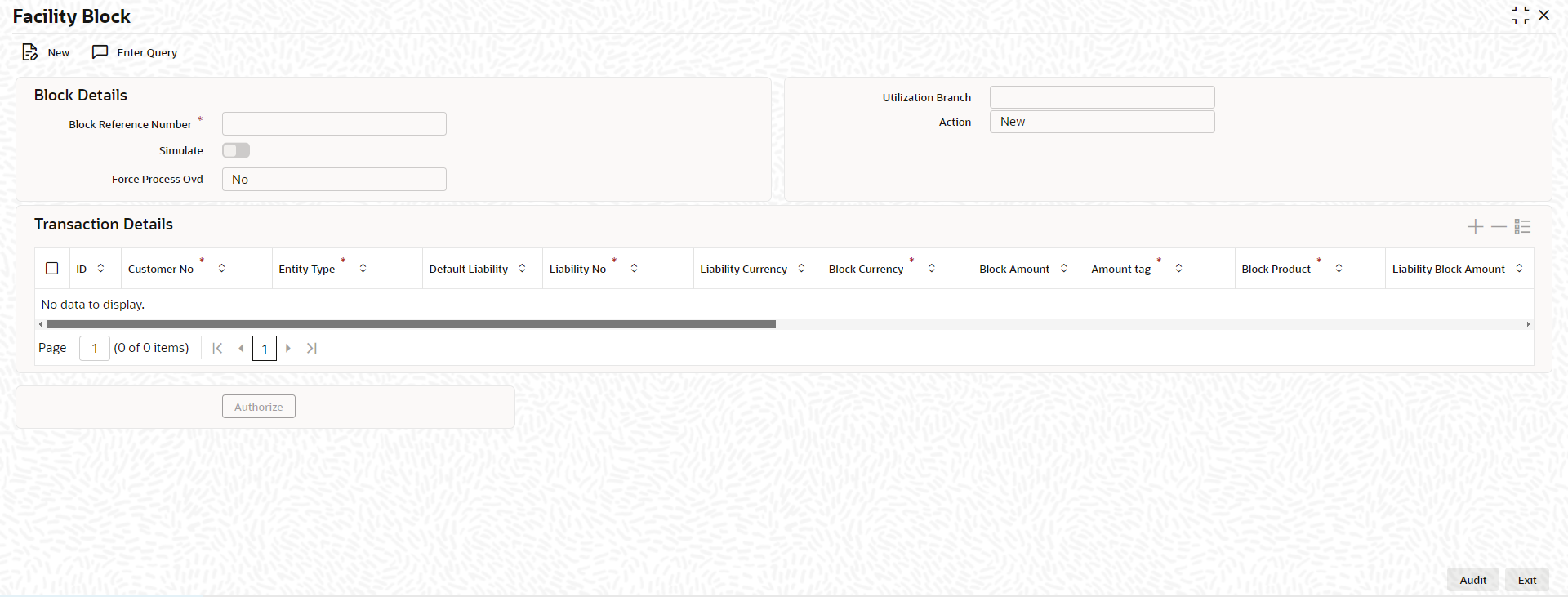

  1. On the Home screen, specify GEDFBLCK in the text box and click the Next icon.
    The Facility Block screen is displayed.
  2. On Facility Block screen, click New and specify the fields.
    Table 2-89 Facility Block - Field Description
    Field Description
    Block Reference Number Specify the unique number which is to be assigned for every block to be created.
