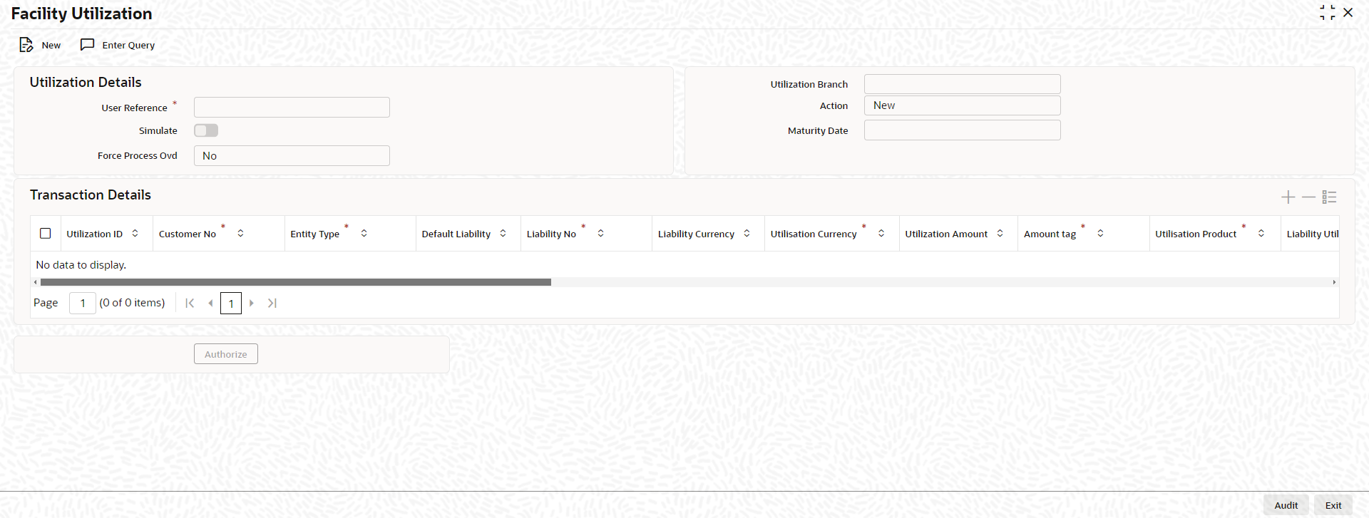

The Facility Utilization screen GEDFUTIL is a dedicated screen for capturing utilization request specific to facilities. You can either capture the facility utilization request through GEDUTILS or GEDFUTIL screen.
  1. On the Home screen, specify GEDFUTIL in the text box and click the Next icon.
    The Facility Utilization screen is displayed.
    Figure 2-37 Facility Utilization
  2. On Facility Utilization screen, click New and specify the fields.
    Table 2-106 Facility Utilization - Field Description
    Field Description
    User Reference Specify a unique reference number for the transaction.
    Utilization Branch Branch Code is displayed here. It indicates the transaction branch code.
