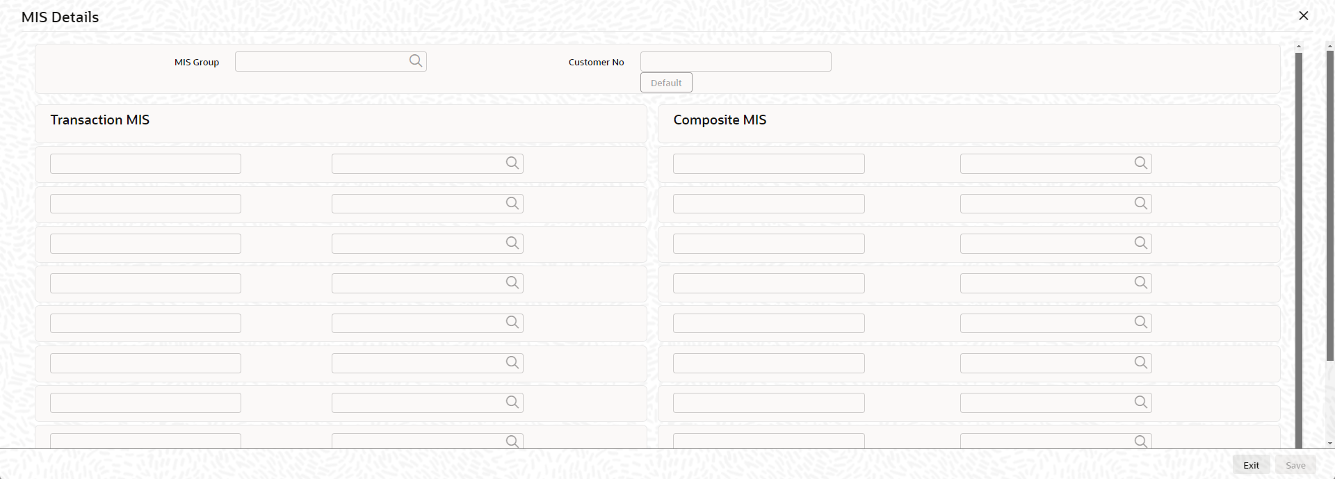

  1. On Facilities Maintenance screen, click the MIS Class tab.
    The MIS Details screen is displayed. For more information on fields, refer to the field description table.
    Table 2-43 MIS Details - Field Description
    Field Description
    MIS Group Click the Search icon and select the MIS Group from the list of groups configured in MIDGRPMT screen. This field gets defaulted based on fee class selection or select the MIS group
    Customer No This field displays the customer number for which the composite MIS are fetched from STDCIF screen. Composite MIS codes will be fetched from STDCIF screen, if the ELCM is integrated with ROFC (external system).
    Default Click this button to fetch the composite MIS codes maintained for the customer in STDCIF screen, if there is only one customer allowed at the Facility in limit restrictions or if there is only one customer linked to the liability.
    User must click this button each time you make changes to the customer in facility limit restriction or at liability. Thus the system can fetch and default the updated composite MIS.
    Transaction MIS Click the Search icon and select the transaction type of MIS code based on the selected MIS Group or the Transaction MIS code associated with the fee class.
    Composite MIS Click the Search icon and select the composite type of MIS code based on the selected MIS Group or the Composite MIS code associated with the fee class.
    MIS Code Transaction and Composite MIS codes configured in GLDCLSMT or MIDGRPMT screen are auto-populated based on the selected MIS Group or fee class.
    User can also add, modify or delete the MIS codes of type Transaction and Composite.
    Note: MIS Codes of Customer and Fund Types will not be populated in the MIS Class screen and the same cannot be used for facility maintenance.
    MIS Class Displays the MIS class based on the selected MIS code.
  2. Click Save to navigate to the Facilities Maintenance screen.
