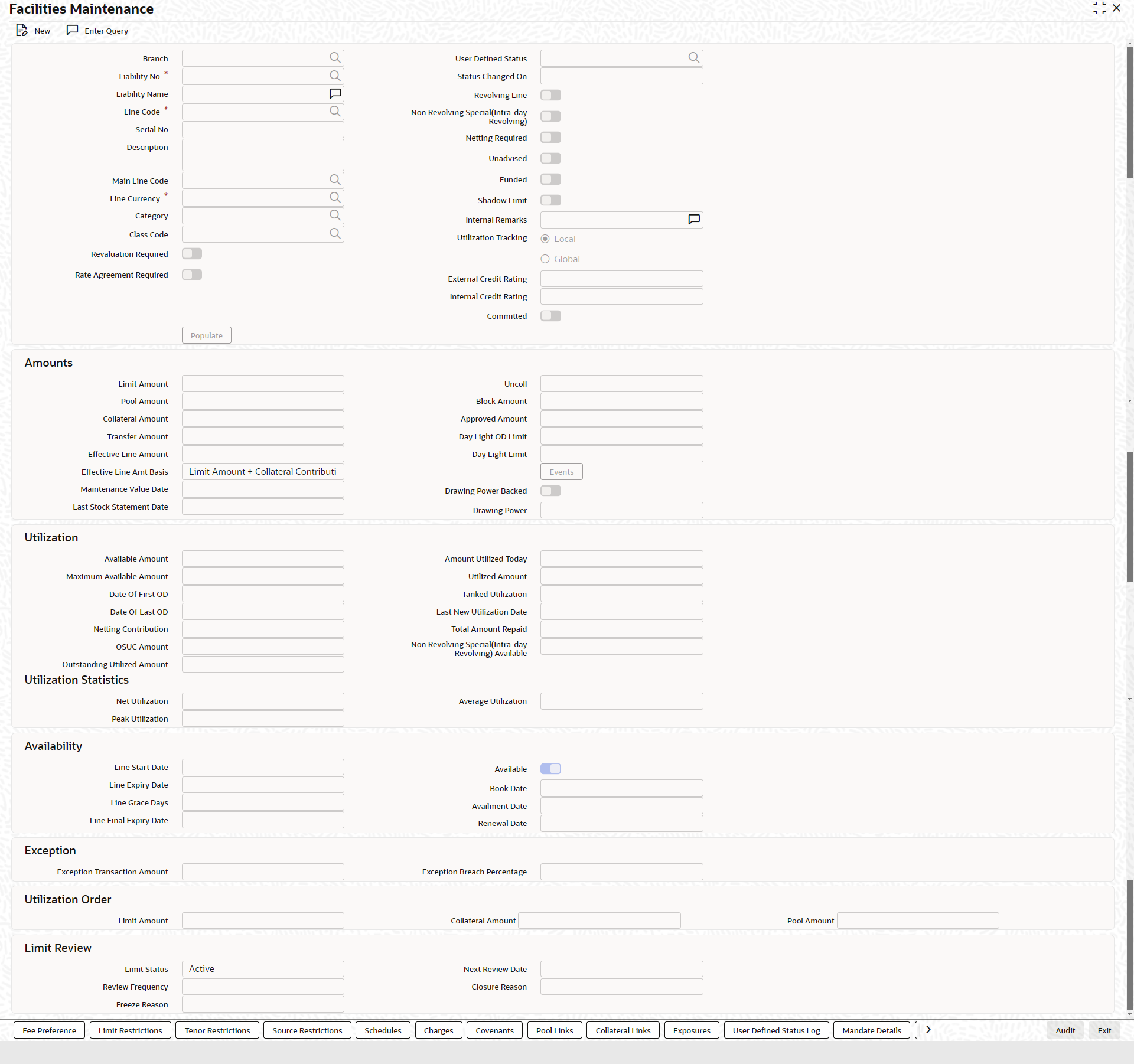

2.2 Facilities Maintenance
This topic describes about the detailed information on facility maintenance such as facility creation and amendment.
The fields, which are marked with an asterisk, are mandatory.The system allows user to maintain credit limits for a Line Code - Liability Code combination in the Facilities Maintenance screen GEDFACLT.
- On the Home screen, specify
GEDFACLT in the text box and click the
icon.The Facilities Maintenance screen is displayed. - On Line Code Maintenance screen, click
New and specify the fields.For more information on fields, refer to the field description table.
Table 2-4 Facilities Maintenance - Field Description
Field Description Branch By default, the system displays the branch code in which facility has to be created. To change, click the

Liability Name Displays the name based on the selected liability number. Line Code Click the
icon and select the line code to which the
liability ID has to be associated. Allocating credit limits
for the line-liability combination can be done. The
customer(s) who fall under this liability code avails credit
facilities under this Credit line.
By linking a credit line to a liability code the customer also gets linked to the credit line. This is true because a liability code has been assigned to every credit seeking customer and the credit facilities granted to the customer are defined and tracked with this code.
User can either enter the line code or select from a drop-down list which picks the Line Code details maintained in the GEDLNCOD screen.
Serial Number Each time a Liability - line code combination is specified, Oracle Banking Enterprise Limits Management system always defaults 1 as serial number. Thus, for every new record entered for a Liability No-Line Code combination, a serial number is defaulted to 1. The Liability - Line- Serial number forms a unique combination for facility identification. Note: If a second facility is created with the same line code, then an error appears on clicking Save. To create multiple facilities, user can also select the line code from the list of values and default the values by clicking on Populate button. The value of line code can then be changed and saved.
Description Displays the name based on the selected line code. Main Line Code Click the
icon and select the main line code, if the facility
to be created is a sub-line.
If the main line code is not specified, then the system defaults the line code as the main line code.
For NRS line, the following mainline and sub-line combinations are supported:- NRS Main line and Revolving Sub-line
- Revolving Main line and NRS Sub-line
For more information, refer Table 2-5.

Field Description Limit Amount Specify the limit for the facility. If user have maintained schedules for limits, the system automatically updates the limit amount here on the dates specified for each limit in the schedule. Pool Amount On clicking Save, the system defaults the Pool Amount based on the pools linked in the Pool Links sub-screen. Collateral Amount On clicking Save, the system defaults the Collateral Amount based on the collaterals linked in the Collateral Links sub screen. Transfer Amount The system displays the transfer amount resulting from Facilities Amount Transfer transactions. The value displayed has either the sign "-" or "+", indicating whether the amount is transferred from or to the line. If the sign is "-", then the amount is transferred from the line and if it is "+", then the amount is transferred to the line.
Effective Line Amount Displays the effective line amount. Note:- Based on back value dated transactions, value dated balances of impacted amounts will be updated in addition to updating of book dated balances
- As book dated balance is considered for backdated transactions like utilization, exchange rate as on book date will be considered for cross currency transactions
Effective Line Amt Basis For defining drawing power of line, the elements mentioned below are treated as the basis for the effective line amount calculation. - Line Amount + Collateral
- Line Amount
- Minimum of Line Amount and Collateral
- Minimum (limit amount, DP amount)
Note:- For Drawing Power (DP) backed facility, Effective Line Amount Basis must be Minimum (limit amount, DP amount). the Effective Line Amount Basis cannot be modified for a DP backed facility.
- EFF_LIMIT_AMOUNT can be used while setting up the IC rule for interest calculation based on facility effective limit amount.
Maintenance Value date Specify the value date on which facility amount is modified. That is, the date on which facility amount modified is earlier than Book Date for an active credit line. When an amendment is done on a facility like limit amount, basis, and so on, if maintenance value date is given as a back value date, modification takes effect from the given maintenance value date and appropriately value dated balance is updated. If maintenance value date is not entered during amendment, processing date is default updated. However, maintenance value date cannot be prior to line start date.
If limit amount is modified with a back date as maintenance value date and subsequent to this date, limit was already applied based on an existing schedule, then the effect of limit amount change is only till existing and applied schedule as per this schedule date.
In case of future dated lines, if any amendment done between the booking date and line start date, maintenance value date is updated as Line Start Date.
Uncoll The system displays the uncollected amount. Block Amount Specify the block amount. Approved Amount This is the maximum limit amount allowed for the facility and must be specified whenever user maintain schedule limits. The system ensures that neither the Limit Amount maintained here nor the schedule Limit Amount maintained as part of the limits schedule is greater than the limit specified here. Day Light OD Limit Specify the day light overdraft limit for the line. In case the Day Light OD Limit is specified, the total amount available for utilization = NRS Available amount + Available Amount + Day Light OD Limit.

Utilization Statistics
This section displays the net, peak, and average utilization of the facility in facility currency based on predefined logic.
Table 2-11 Facilities Maintenance - Utilization Statistics - Field Description
Field Description Net Utilization Net Utilization is derived by deducting the collateral value against facility from the outstanding utilized amount. For example, if the facility effective limit amount is 100000, current outstanding utilized amount after payment is 60000, and the value of collateral attached to facility is 40000, then the Net Utilization is 20000 (60000-40000).
Net utilization amount will be zero, if the linked collateral value is greater than the Outstanding (utilized) amount.
If collateral is not linked to the facility, the net utilization amount is the outstanding utilized amount.
The system calculates the net utilization amount everyday while processing BoD batch (ELBFACLT) based on end of day outstanding utilized amount and the collateral value on the previous day.
The Net Utilization will be displayed for both revolving and non-revolving lines. In case of revolving lines, utilized amount is the current outstanding (utilized) amount. Whereas for non-revolving lines, the current outstanding (utilized) amount will be arrived by deducting total repaid amount from the outstanding utilized amount.
Note:- Revaluation of collateral and facility will be considered while calculating the net utilization amount
- Net utilization cannot be reset during the life-cycle of facility
Peak Utilization Peak utilization is the maximum outstanding utilization of a facility over the time period configured in the Global Exposure Parameter Detail screen (GEDPARAM). For example, if Rollover in Days value is specified as 30 or Frequency is selected as Monthly in GEDPARAM, peak utilization is the end of day outstanding utilization amount that is greater than all other end of day outstanding utilization amounts during the configured number of days or in the whole month.
The system calculates the peak utilization as a part of BOD batch process (ELBFACLT).
Average Utilization Average utilization is the average outstanding of the end of day balances over the time period configured in the Global Exposure Parameter Detail screen (GEDPARAM). For example, if Rollover in Days value is specified as 30 or Frequency is selected as Monthly in GEDPARAM, average utilization is the average outstanding of the end of day balances over the configured number of days or the month.
The system calculates the average utilization as a part of BOD batch process (ELBFACLT).
Refer OBELCM Common User Manual for information on utilization statistics configuration for peak and average utilizations.Processing Future Dated Credit Line
