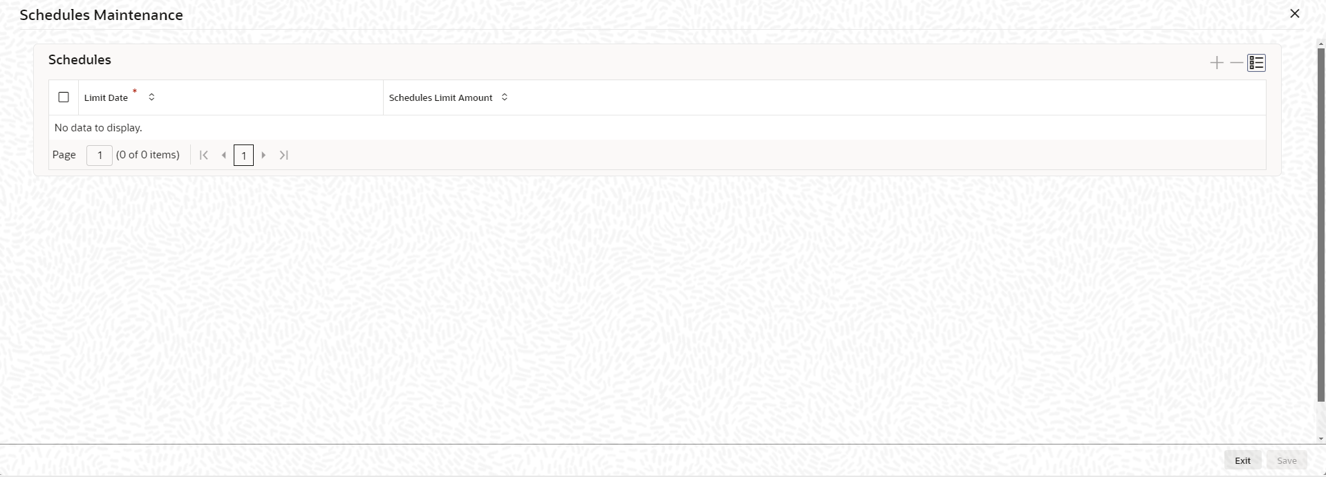

  1. On Facilities Maintenance screen, click the Schedules tab.
    The Schedules Maintenance screen is displayed.
    Figure 2-7 Schedules Maintenance
