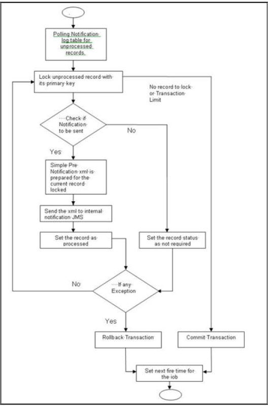

Notification Process
- The trigger on the base table inserts key details into a static notification log table instead of Oracle AQ.
- Once the Job is triggered, a request is sent to the EJB layer from the job execution class and the notification log table is polled for unprocessed records.
- Each unprocessed record is locked.
- The record is verified against the notification maintenance and checked whether the notification is to be sent or not.
- If a notification is to be sent, pre-notification message XML is built and it is sent to internal notify_queue(JMS queue).
- The job is then rescheduled to fire next time based on the previous execution.

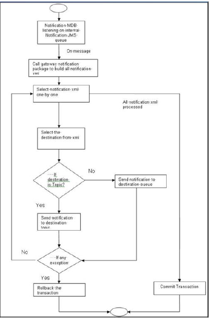

- The Notification MDB listens on the internal notify JMS queue.
- On any message received, the MDB identifies which schema to connect using the JNDI name being present as part of the message XML.
- The Gateway notification processing package is called from MDB to build the actual notifications.
- In MDB the notifications built are processed and sent to the destination specified in the corresponding notification.
- In case of any exception, the whole transaction is rolled back.
- If all notifications are successfully processed then the transaction is committed.
Figure 2-1 Notification Process in Scheduler
