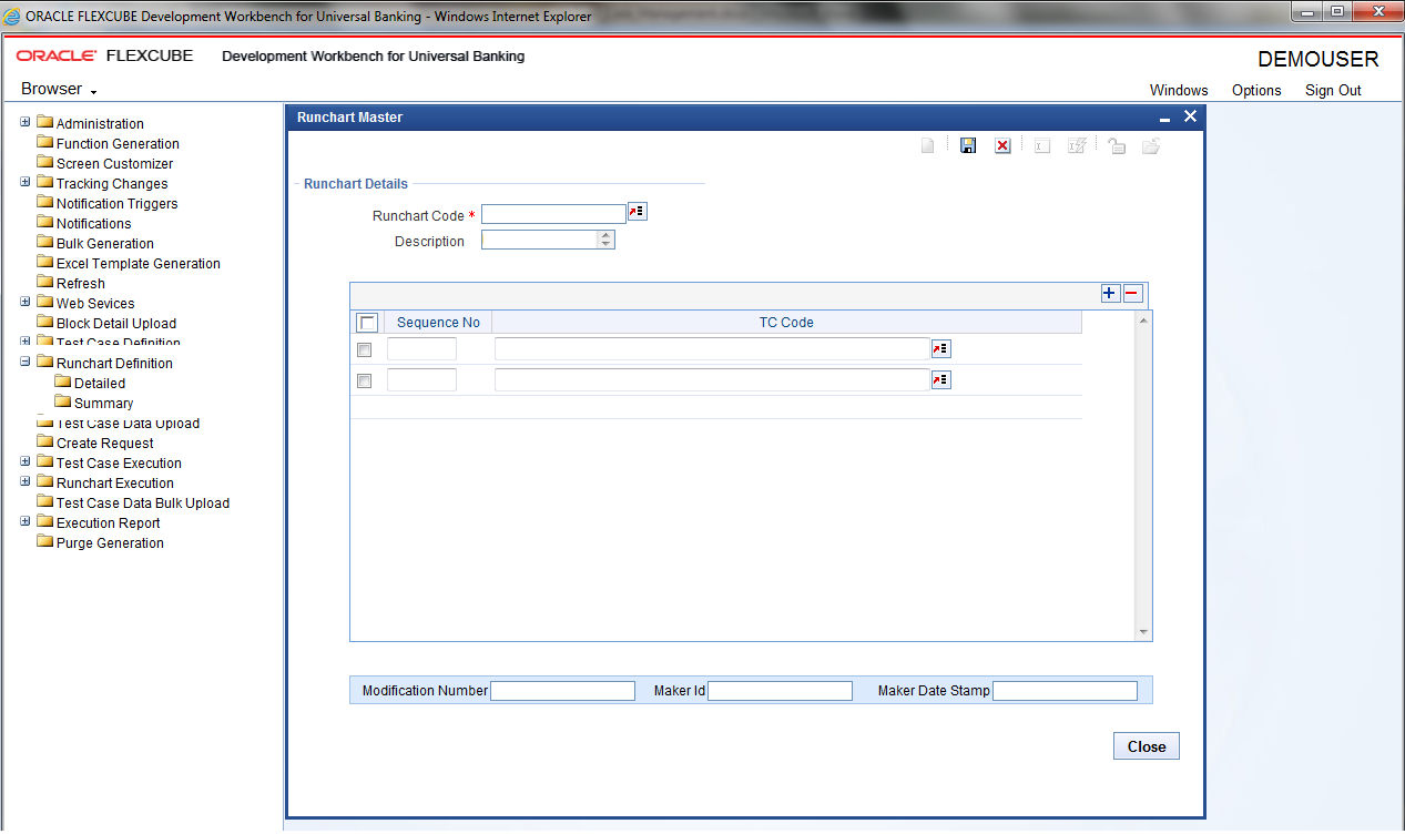

This topic explains the systematic instructions to add multiple test cases and make a single Run Chart to execute at
  1. On the Home Screen, under Browser, expand Runchart Definition and click on Detailed.
    Runchart Master screen is displayed.
  2. On the Runchart Master screen, specify the fields
    Table 10-1 Runchart Master
    Field Description
    Runchart Code Displays the Runchart Code.
    Description Displays the description.
