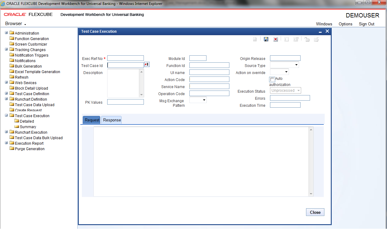

- On the Home Screen, under Browser, expand Test Case Execution and click on Detailed.Test Case Execution screen is displayed.
- On the Test Case Execution screen, specify the fields.For more information on fields, refer to the field description table.
Table 9-1 Test Case Execution
Field Description Exec Ref No Test Case ID Each execution generates a unique reference number, which is used later for viewing the status of the execution. Description Displays the Test Case ID description. Source Type Select the source type from the drop-down. It can be FLEXCUBE or Web Services, depending on whether the execution is done from FLEXCUBE or an external System. Action on override Users can select the applicable value from the drop-down. If overrides occur for a function id, the user can ignore those overrides or stop the execution and give an Error status. Auto Authorization On selecting this check box, the executed records will be authorized records. Execution Status Displays if the record is executed successfully or not.
