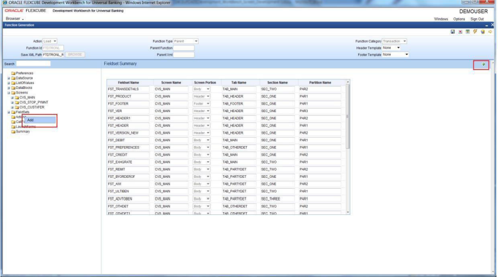

  1. Right-click on the Fieldset Node and select Add Field Set option from the right-click menu.
  2. Or click on the Add Fieldset (+) icon in the top right corner of the Field Set Screen.
    Add FieldSet window displays.
  3. Specify the FieldSet Name field and click on the OK button.
    The standard naming convention for fieldsets is FST_< Descriptive Code of the Field Set>.
    For Example: FST_VERSION
