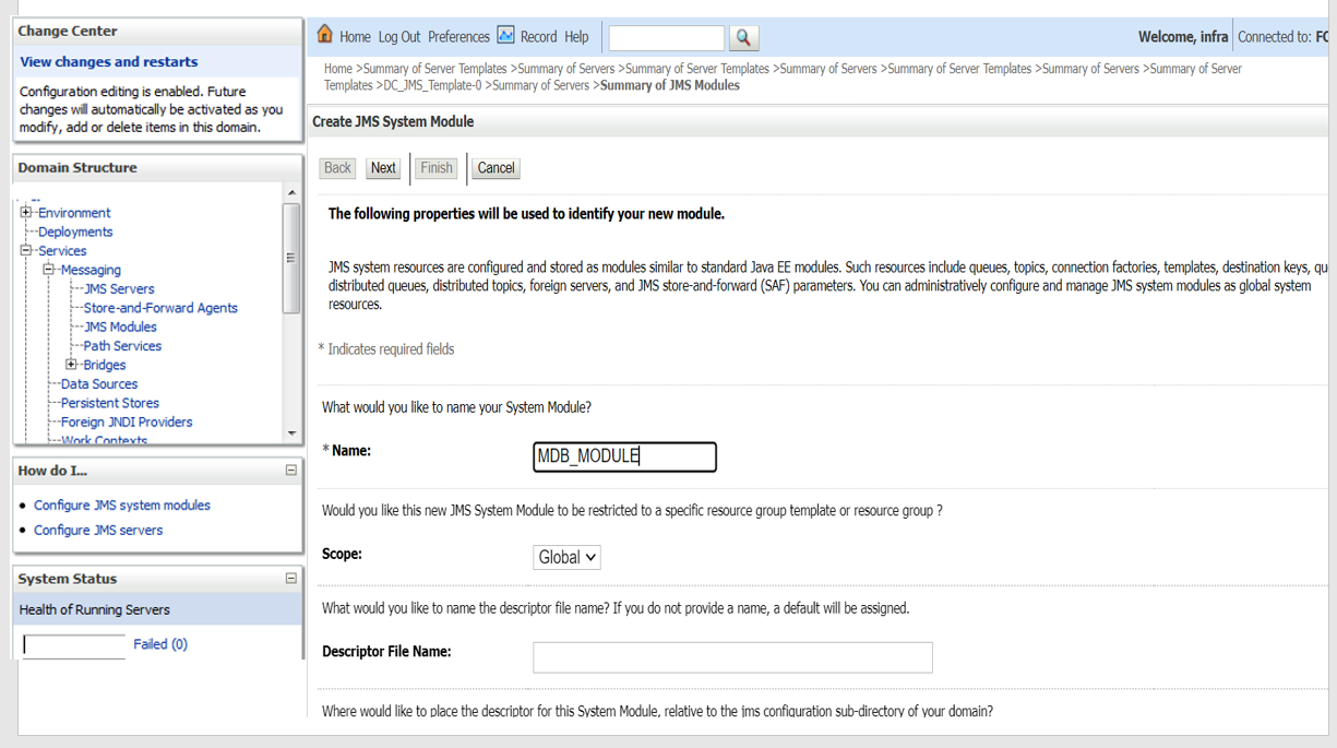

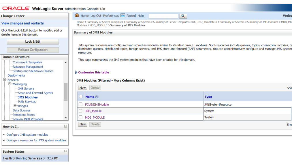

Configuring JMS on Weblogic Server 12c Foreign Server Creation Create Foreign Server Module 7.1 Create Foreign Server Module This topic explains systematic instructions to create the MDB Module. Under the Domain Structure left panel, navigate to the Services drop-down option, and click Messaging, and then JMS Modules.The Summary of JMS Module screen displays. Figure 7-1 Summary of JMS Module Click New under the Customize the table tab. The Create JMS System Module screen displays. Enter the Name as MDB_MODULE, and then click Next.The Targets tab displays under the Create JMS System Module screen. Figure 7-2 Create JMS System ModuleDescription of "Figure 7-2 Create JMS System Module" Select the target as Cluster-App, and then click Next.The Add resources to this JMS system module tab displays under the Create JMS System Module screen. Figure 7-3 Add resources to this JMS system module Select the check box, and click Finish.The MDB_MODULE is created. Figure 7-4 Summary of JMS ModulesDescription of "Figure 7-4 Summary of JMS Modules" Parent topic: Foreign Server Creation
