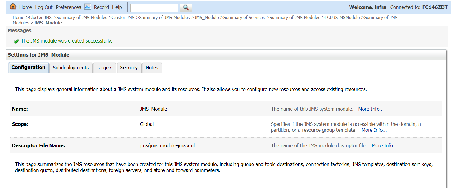

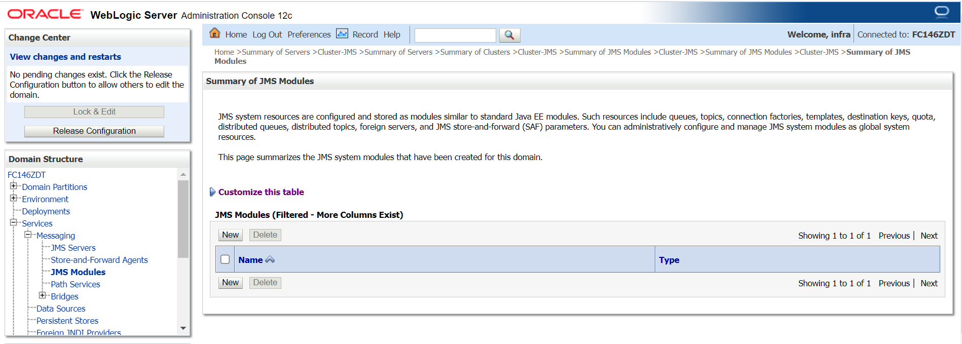

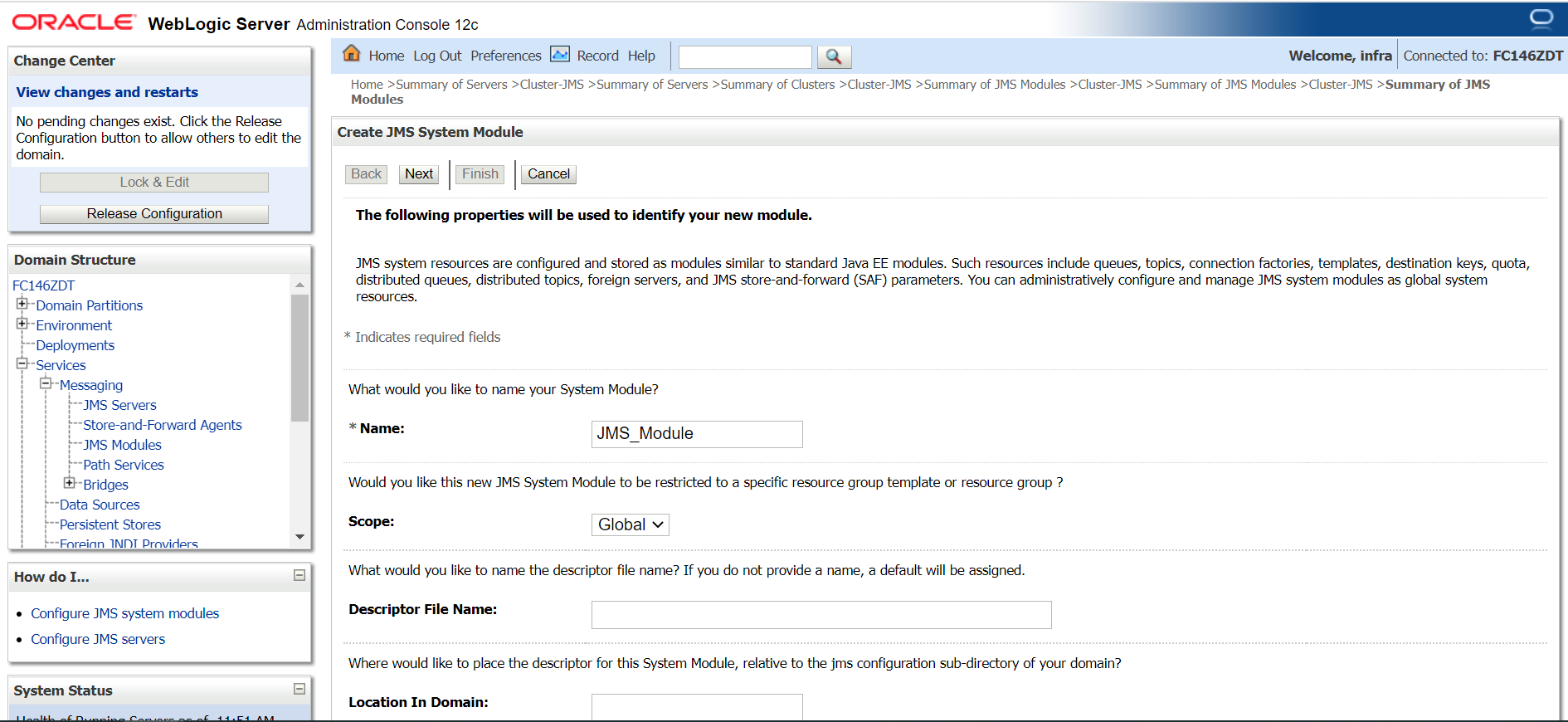

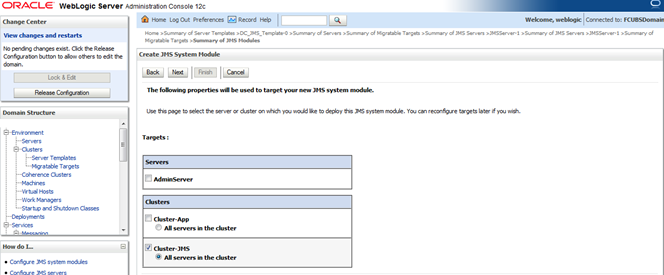

Configuring JMS on Weblogic Server 12c Introduction Create JMS Module 5.1 Create JMS Module This topic explains systematic instructions to create the JMS Module. Under the Domain Structure left panel, navigate to the Services drop-down option, and click Messaging, and then JMS Modules.The Summary of JMS Module screen displays. Figure 5-1 Summary of JMS ModuleDescription of "Figure 5-1 Summary of JMS Module" Click New under the JMS Module tab. The Create JMS System Module screen displays. Figure 5-2 Create JMS System ModuleDescription of "Figure 5-2 Create JMS System Module" Enter the Name as JMS_MODULE, and click Next.The Targets tab displays under the Create JMS System Module screen. Figure 5-3 TargetsDescription of "Figure 5-3 Targets" Select the target as Cluster-JMS, and then click Next.Add resources to this JMS system module tab displays under the Create JMS System Module screen. Figure 5-4 Add resources to this JMS system moduleDescription of "Figure 5-4 Add resources to this JMS system module" Select the check box, and click Finish.The JMS_MODULE is created. Figure 5-5 Settings For JMS_MODULE - MessagesDescription of "Figure 5-5 Settings For JMS_MODULE - Messages" Parent topic: Introduction
