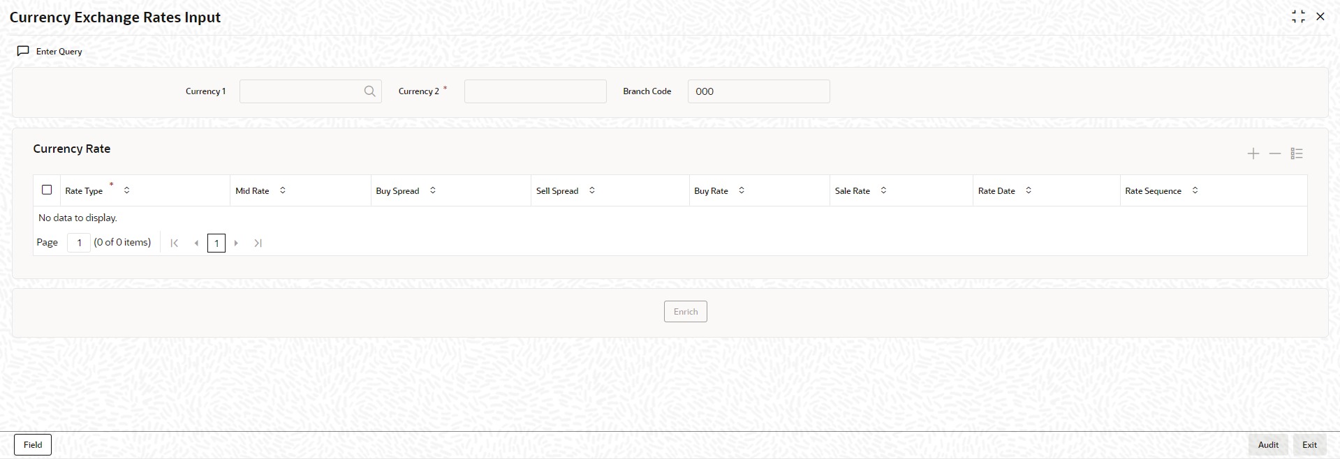

  1. On Homescreen, type CYDRATEE in the text box, and click Next.
    The Currency Exchange Rates Input screen displays.
    Figure 1-16 Currency Exchange Rates Input
  2. On the Currency Exchange Rates Input screen, specify fields.
    Table 1-18 Currency Exchange Rates Input - Field Description
