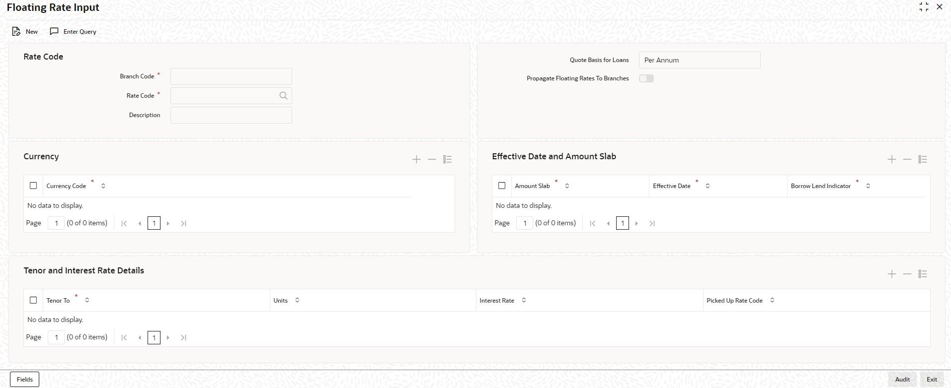

- On Homescreen, type CFDFLTRI in the text box, and click Next.The Floating Rate Input screen displays.
Figure 1-19 Floating Rate Input
- On the Floating Rate Input screen, specify the fields.
The fields, which are marked with an asterisk, are mandatory.For more information on fields, refer to the field description table.
