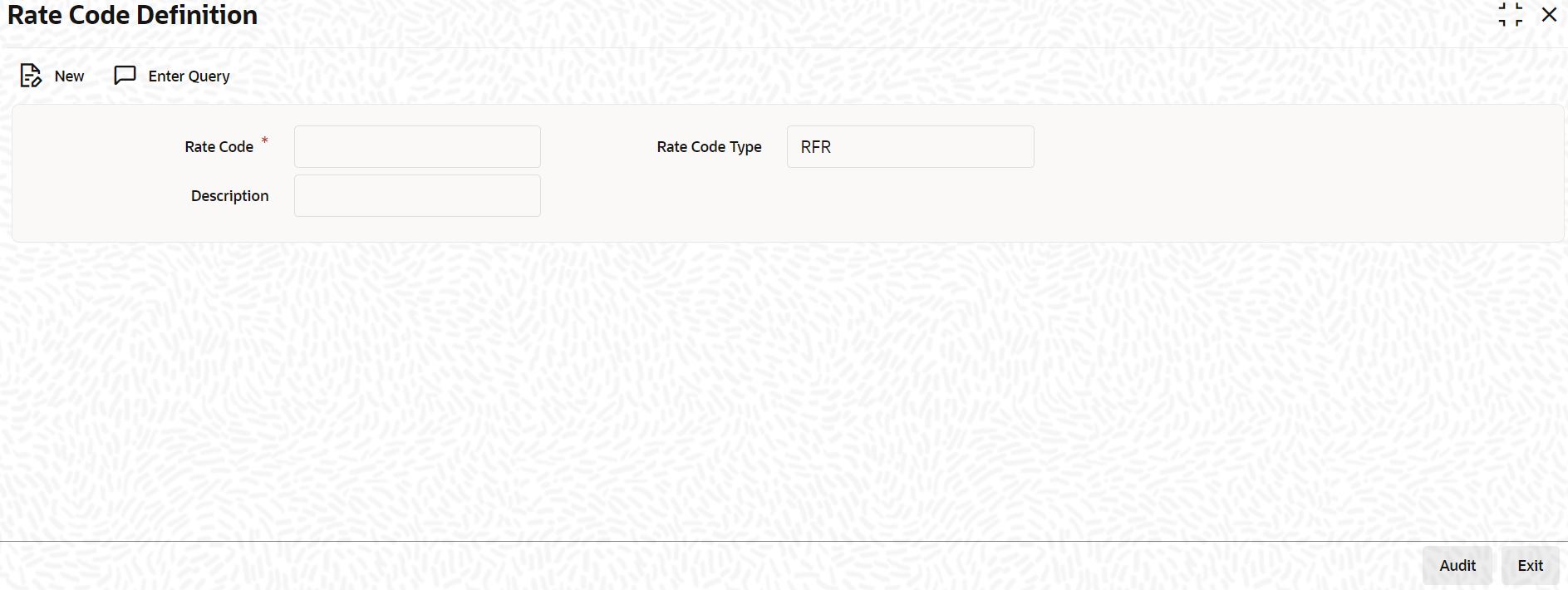

  1. On Homescreen, type CFDFRTCD in the text box, and click Next.
    The Rate Code Definition screen displays.
    Figure 1-20 Rate Code Definition
  2. On the Rate Code Definition screen, specify the fields.
    Table 1-26 Rate Code Definition - Field Description
    Field Description
    Rate Code Specify a code to identify the Floating Rate being defined. Several currencies can be associated with the rate code and specify rates for each currency. While processing a contract, specify this code to make the rate applicable to the contract.
    Description Specify a unique description for the rate code.
    Rate Code Type Select the rate code type from the drop-down list. By default, the system displays the value as RFR which is used to maintain the RFR rate for the rate code. The following options are also available for selection in the drop-down list:
    • Inflation - Used to maintain inflation Index for the rate code
    • Others - Used to maintain rates other than RFR and Inflation. For example, IOBR
  3. Click Exit to end the transaction.
