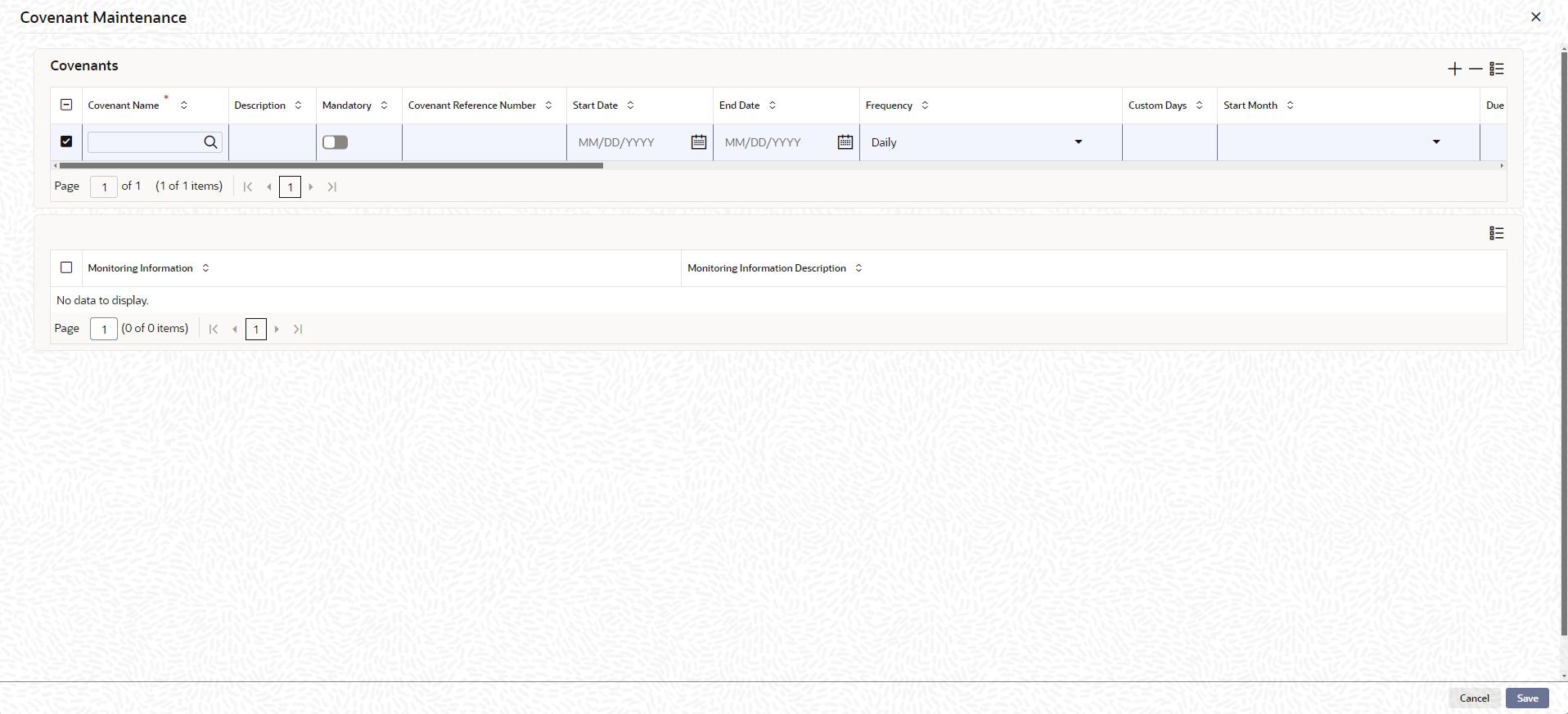

This topic describes about the procedure to maintain covenant.
- On Customer Covenant Linkage screen, click
Covenant tab.The Covenant Maintenance screen displays. For more information on fields, refer to the field description table.
