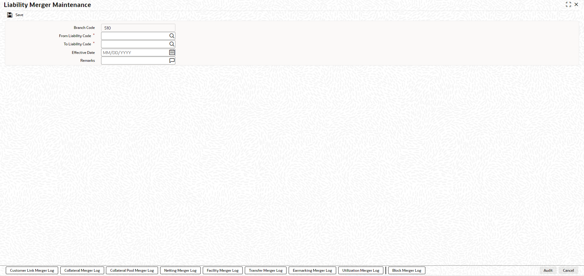

  1. On the Home screen, specify GEDMERGE in the text box and click the Next icon.
    The Liability Merger Maintenance screen displays.
    Figure 2-31 Liability Merger Maintenance
  2. On Liability Merger Maintenance screen, click New and specify the fields.
    Table 2-29 Liability Merger Maintenance - Field Description
    Field Description
    Branch Code System defaults the branch code as the branch from which the Liability Merger Maintenance screen is launched and New option is selected.
    From Liability Code Click the Search icon and select the code of liability which is to be merged with another liability using the adjoining option list.
    To Liability Code Click the Search icon and select the code of liability with which the liability specified under From Liability Code must be merged using the adjoining option list.
    To Liability Code can be from any different branch as well.
    Effective Date Specify the date from which the merger of liabilities must take effect.
    Remarks Specify the remarks about the Liability Merger Maintenance.
