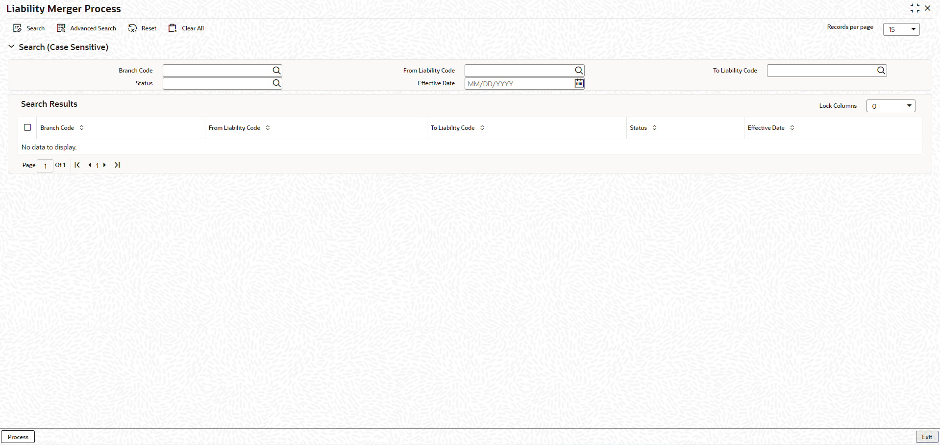

- On the Home screen, specify
GESMRGTR in the text box and click the
icon.The Liability Merger Process screen displays. - Click the Process option to initiate the merger of maintained
liabilities.
