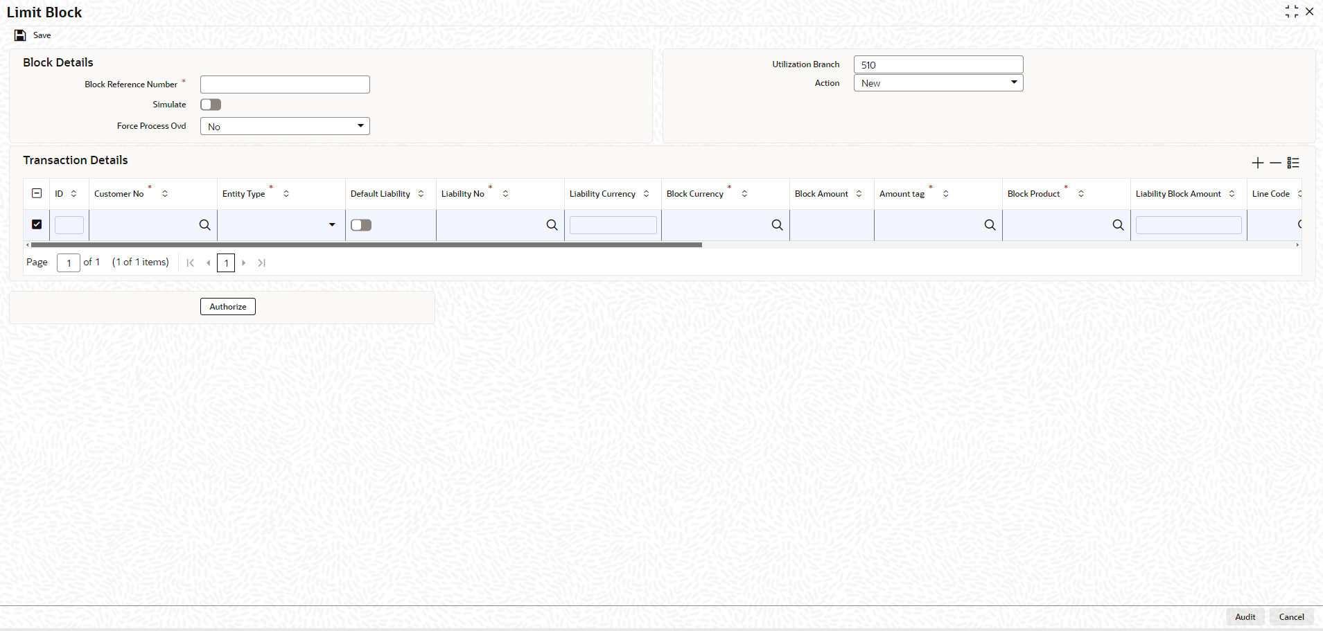

This topic describes about the detailed information on limit block screen.
The fields, which are marked with an asterisk, are mandatory.- On the Home screen, specify
GEDBLCKS in the text box and click the
icon.Block on facility with FX setting:
Fixed / Derived rate given as part of FX Revaluation will be considered for Blocking of transactions.
For example: When only sub-line has FX Revaluation setting, Fixed / Derived rate given in FX revaluation screen is considered for blocking transaction on sub-line. Whereas main line & liability are blocked considering setting.
When main line and sub line have FX Revaluation setting, Fixed / Derived rate at respective levels (Sub line and Main line) will be considered for blocking transaction, liability will be blocked considering GEDPARAM setting.
- On Limit Block screen, click New
and specify the fields.For more information on fields, refer to the field description table.
Table 2-61 Limit Block Maintenance - Block Details - Field Description
Field Description Block Reference Number Specify the unique number which is to be assigned for every block that has been created. Simulate Click the toggle status to indicate that the details for the transaction being entered should be used only for simulation and not stored permanently within the system. After a successful simulation of a transaction, the system displays the utilized amount for the facility and the for the liability. Force Process Ovd Indicates whether transaction should ignore the overrides occurred in the process or not. Utilization Branch Branch code is displayed here. It indicates the transaction branch code. Action During new block, you can perform below mentioned operations for all entities. - New Block

Facility Available Amount Block Amount Block Status 10000 0 A Table 2-76 Limit Block Maintenance - Transaction Details - Field Description
Field Description ID Indicates the transaction ID. Customer No The system displays the customer number to which the Facility, Liability, Collateral, Collateral Pool are linked. The option list displays all valid customer numbers linked to the facility and liability number selected on this screen. You can select the customer number from the option list. Entity Type The system displays the entity type to which the entity is associated. Default liability When a customer number is selected from list of values, default liability flag is checked by default and Liability No column shows the liability to which this customer is linked as default. If a customer is linked to multiple liabilities and block transaction needs to consider the entity belonging to a liability which is not default, then default liability needs to be unchecked and liability number can be selected from list of values against this field.
Liability No Liability which is linked to customer in Customer to Liability Link Maintenance screen (GEDCULIK). Liability Currency The currency with which the liability is associated. Block Currency Specify the currency based on which the Block amount for the limit has to be considered. Block Amount Specify the amount to be blocked. Amount Tag The amount tag entered in Amount Tag Maintenance screen is displayed here. Amount tag would be required when there are multiple utilization for the same reference number. This tag would indicate which component needs to be authorized.
Block Product Specify the product for the transaction. Liability Block Amount Displays the liability blocked amount. Line Code Specify the facility here. Serial No Indicates the Enterprise Limits and Collateral Management generated unique identifier for the facility. The Serial No field is disabled and it gets defaulted from the Facilities Maintenance screen. Collateral Code Specify the collateral code here. Each Collateral code should be unique. Pool Code Specify the Pool Code here. The pool code assigned to each collateral pool can be linked to a liability while creating credit limits. Limit Currency The limit currency of the facility. Limit Block Amount Specify the amount blocked from the limit in limit currency. In case of cross currency block transaction, convert the block amount from the transaction currency to Limit Currency and mention it as limit block amount. If the limit block amount is specified, foreign currency revaluation and currency revaluation is not applicable for the block transaction.
