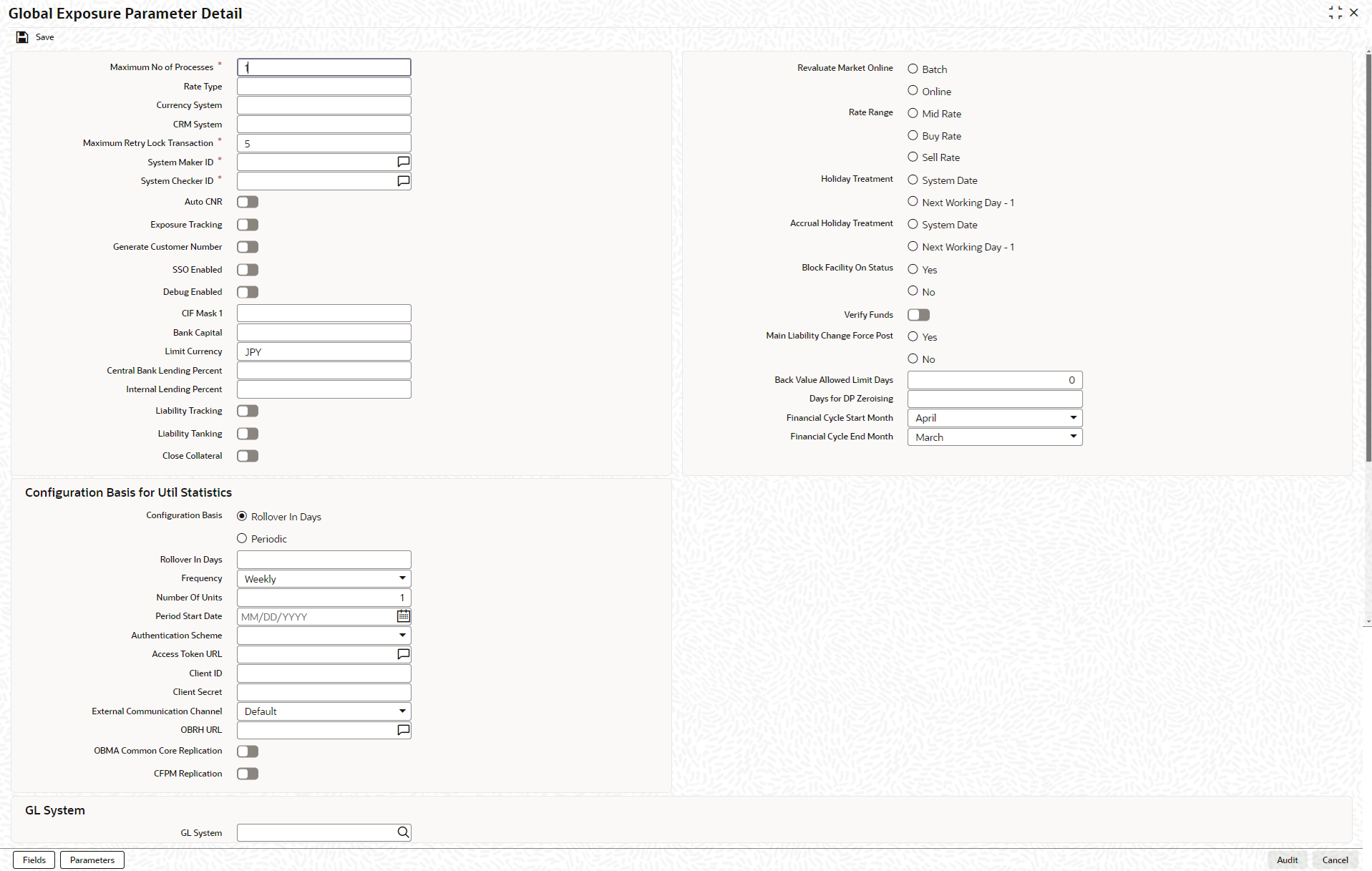

  1. On the Home screen, specify GEDPARAM in the text box and click the Next icon.
    The Global Exposure Parameter Detail screen displays.
    Figure 2-60 Global Exposure Parameter Detail
  2. On Global Exposure Parameter Detail screen, click New and specify the fields.
    Table 2-77 Global Exposure Parameter Detail - Field Description
