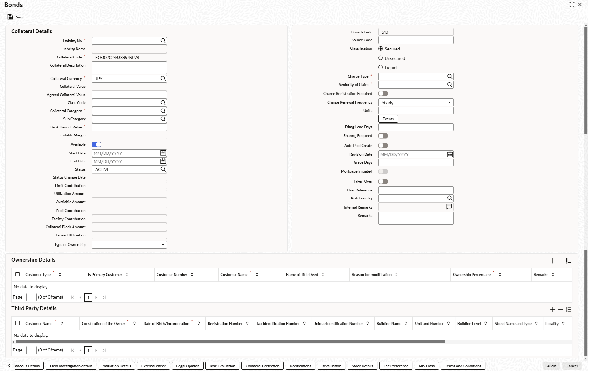

  1. On the Home screen, specify GCDCOLBO in the text box and click the Next icon.
    The Bonds screen is displayed.

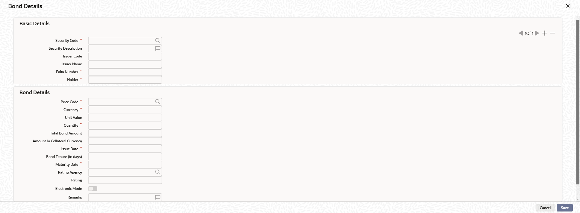

  2. On Bonds screen , click the Bond Details tab.
    Multiple bond records can be linked to the same customer collateral. Collateral value is updated duly considering amount of these bonds.
    The Bond Details screen is displayed. For more information on fields, refer to the field description table.
    Table 1-70 Bond Details - Field Description
    Field Description
    Security Code Click the Search icon and select the security code from the list.
    Security Description, Issuer Code, and Issuer Name Displays the details based on the selected security code.
    Folio Number Folio number is unique across different bonds linked to the collateral.
    Holder Specify the name of bond holder.
    Table 1-71 Bonds Details - Field Description
    Field Description
    Price Code Based on price code for the security selected, unit value is defaulted from security maintenance.
    Currency Select currency of bond from the adjoining list.
    Unit Value This field gets defaulted for the selected Price Code.
    Quantity Specify the quantity of bonds.
    Total Bond Amount Total bond amount is calculated for the quantity specified considering unit value.
    Amount In Collateral Currency Wherever bond currency is different from collateral currency, bond value in the collateral is converted to collateral currency as per rate configured and collateral value is updated.
    Issue Date Specify the issue date of bond. Issue date cannot be future dated.
    Bond Tenure (in days) Bond tenure is calculated based on issue date and maturity date.
    Maturity Date Maturity date of bond is considered as collateral end date and collateral value is updated as zero. Maturity date cannot be back dated.
    When multiple bonds with different end dates are linked to the collateral, collateral value is appropriately reduced based on end of the bond.
    Rating Agency and Rating Select the rating for the bond from the agency.
    Electronic Mode Select this check box if the bonds are in electronic mode.
    Remarks Specify the remarks if any.
