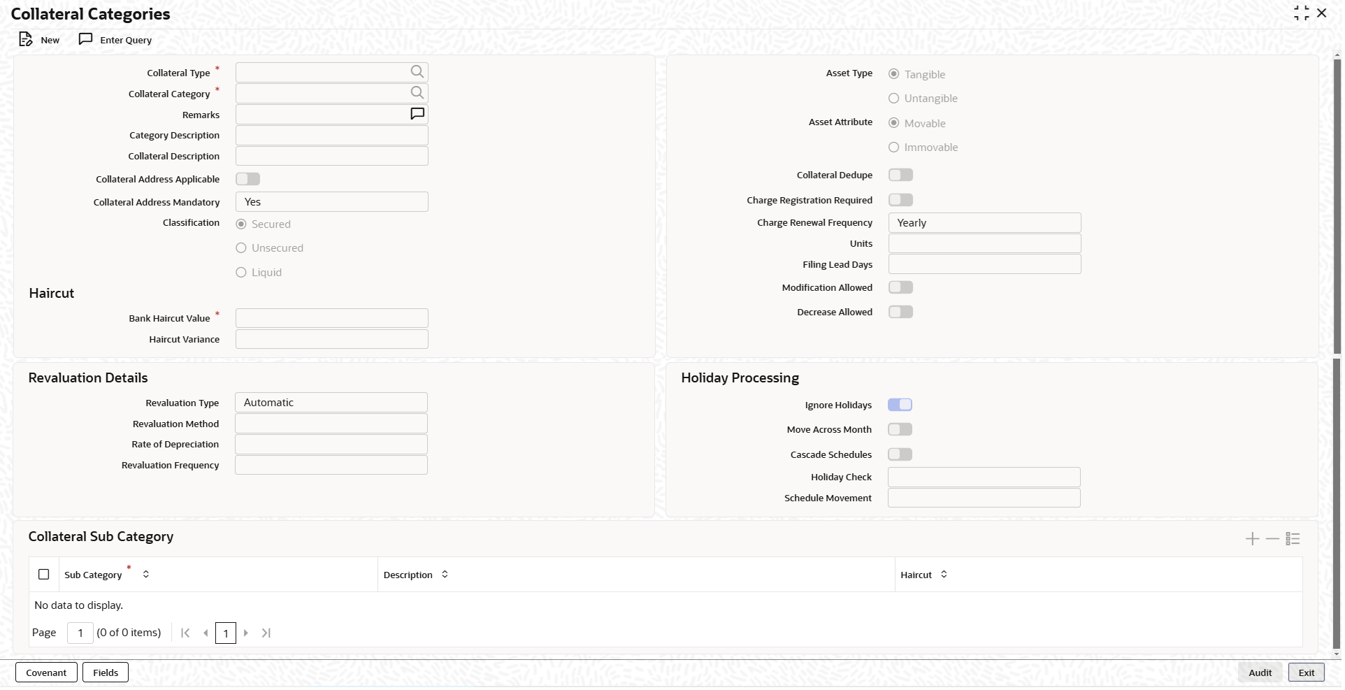

  1. On the Home screen, specify GCDCOLCA in the text box and click theNext icon.
    The Collateral Categories screen is displayed.
    Figure 1-2 Collateral Categories
  2. On Collateral Categories screen, click New and specify the fields.
    Table 1-2 Collateral Categories - Field Description.
    Field Description
