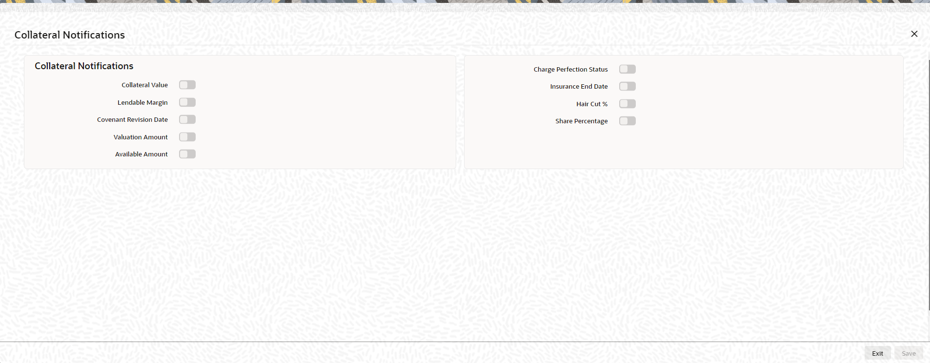

  1. On Collaterals Maintenance screen, click the Notifications tab.
    The Collateral Notifications screen is displayed.
    Figure 1-37 Collateral Notifications
    Table 1-38 Notifications
