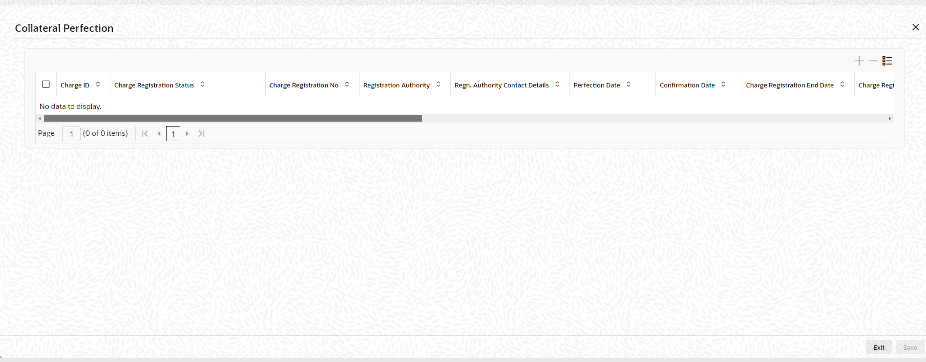

  1. On Collaterals Maintenance screen, click the Collateral Perfection tab.
    The Collateral Perfection screen is displayed.
    Figure 1-35 Collateral Perfection
    Table 1-36 Collateral Perfection - Field Description
