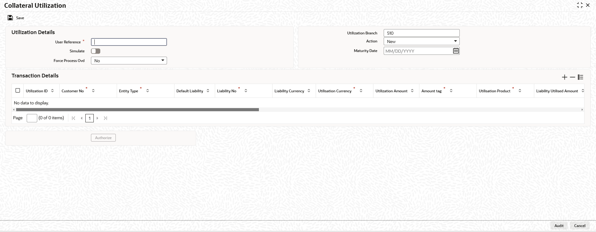

The Collateral Utilization screen (GCDUTILS) is a dedicated screen for capturing utilization request specific to collaterals. You can either capture the collateral utilization request through GEDUTILS or GCDUTILS screen.
The fields, which are marked with an asterisk, are mandatory.
  1. On the Home screen, specify GCDUTILS in the text box and click the Next icon.
    The Collateral Utilization screen is displayed.
    Figure 1-97 Collateral Utilization
  2. On Collateral Utilization screen , click New and specify the fields.
