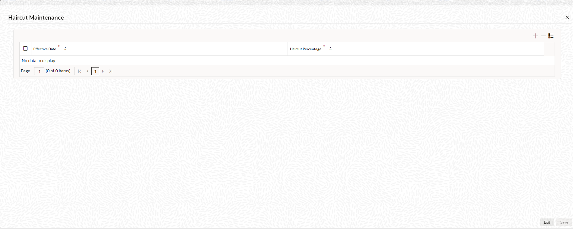

  1. On Collaterals Maintenance screen, click the Haircut Schedule tab.
    The Haircut Maintenance screen is displayed.
    Figure 1-27 Haircut Maintenance
    Table 1-29 Haircut maintenance - Field Description
    Field Description
    Effective Date Specify the effective date on which the haircut percentage becomes effective from the adjoining option list.
    Haircut Percentage Specify the haircut percentage of the Collateral. You can enter values between 1 to 100.
    • System applies the Haircut Percentage to the collateral on the schedule effective date during the BOD process of the collateral batch (GCBCOLAT).
    • Collateral haircut schedule will be considered for net utilization calculation at facility level, since it affects the collateral contribution to the facility.
