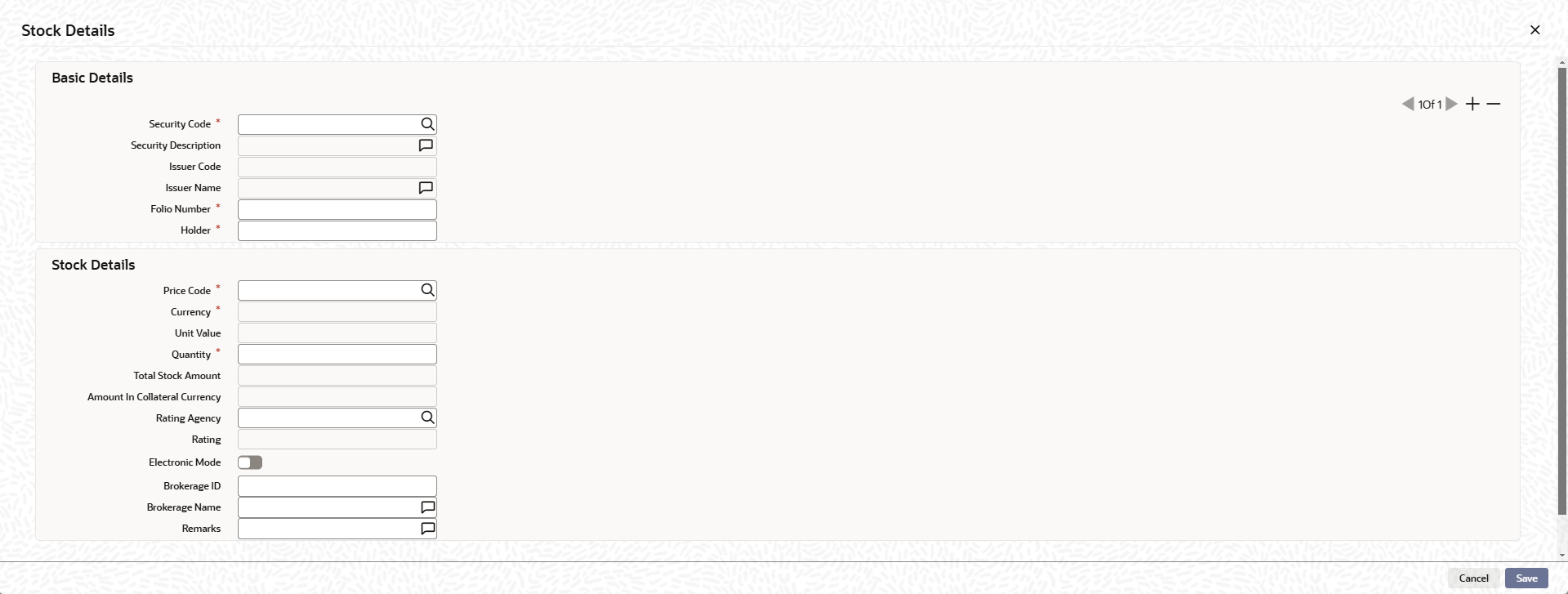

  1. On the Home screen, specify GCDCOLLS in the text box and click the Next icon.
    The Stocks screen is displayed.
  2. On Stocks screen , click the Stock Details tab.
    The Stock Details screen is displayed. For more information on fields, refer to the field description table.
    Table 1-63 Stocks Details - Fields description
    Field Description
    Security Code Click the Search icon and select the security code from the adjoining option list of collateral type stocks. Security Code should be unique across the child records of the collateral.
    Security Description The system displays the security code description.
    Issuer Code and Issuer Name Issuer code and security issue name for the security gets populated based on security code selected.
    Folio Number Folio number is unique across multiple stocks records in the same collateral.
    Holder Specify the name of stock owner / bearer.
    Stock Details Specify the details under this section.
    Price Code and Unit Value Based on price code for the security selected, unit value is defaulted from security maintenance. The system displays the unit value from the Securities (GCDSECTY) screen.
    Currency Click the Search icon and select the currency from the list.
    Quantity Specify the quantity of stocks.
    Total Stock Amount Total stock amount is calculated for the quantity specified considering unit value.
    Amount in Collateral Currency Wherever stocks value currency is different from collateral currency, stock value in the collateral is converted to collateral currency as per rate configured and collateral value is updated.
    Rating Agency Click the Search icon and select the rating agency from the adjoining list of values which has rated the security.
    Rating Specify the rating of the securities.
    Electronic Mode Select this check box if the securities are in electronic mode.
    Brokerage ID and Name Specify the broker id and name. Brokerage Id and Brokerage name are mandatory when Electronic mode is selected.
    Remarks Specify remarks if any
    Following sub-screens are not relevant to stocks type of collateral. Appropriate message is displayed when the same are invoked for entering data at the time of collateral maintenance.
    • Insurance
    • Field Investigation details
    • Valuation details
  3. Click Save to save the record.
