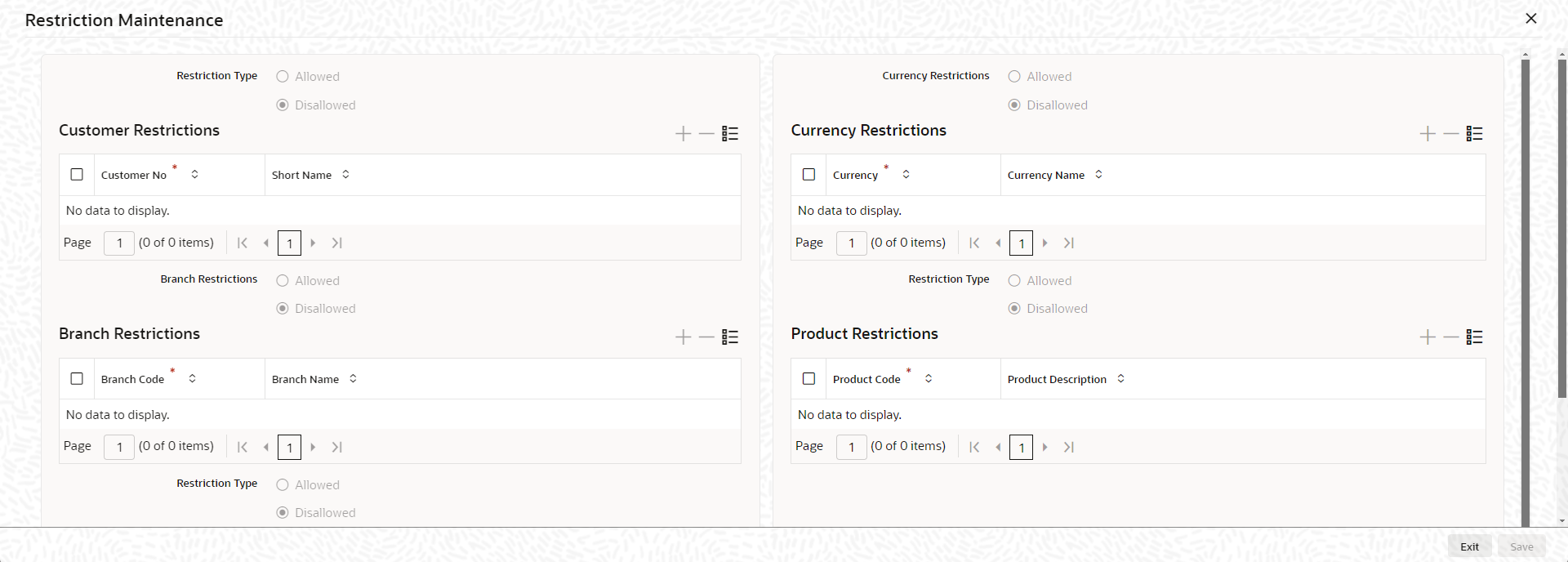

- On Facilities Maintenance screen, click the
Limit Restrictions tab.The Restriction Maintenance screen is displayed For more information on fields, refer to the field description table.
Table 2-62 Restriction Maintenance - Field Description
Fields Description Restriction Type Select the restriction type for each restrictions defined for the facility from the following options: - Allowed
- Disallowed
Customer Restrictions Specify the details under Customer Restrictions section. Customer No Click the
icon and select the customer number linked to
liability from linked customers sub-system in liability
maintenance.
Short Name Specify the short name for the customer. Currency Restrictions Specify the details under Currency Restrictions section. Currency Click the
icon and select the currency from the list.
Currency Name Displays the currency name based on the selected currency. Branch Restrictions Specify the details under Branch Restrictions section. Branch Code Click the
icon and select the branch code from the
list.
Branch Name Displays the branch name based on the selected branch code. Product Restrictions Specify the details under Product Restrictions section. Product Code Click the
icon and select the product code from the list.
Allowed products at the sub-line level must be equal to or a
sub set of the allowed products at the main line level.
Product Description Displays the description based on the selected product code. Exposure Restrictions Specify the details under Exposure Restrictions section. Exposure Code Click the
icon and select the exposure code from the
list.
Exposure Description Displays the description based on the selected exposure code. Exposure Type Specify the exposure type. Exposure Type Code Specify the code for the exposure type. Maintaining Customer Restrictions for a Line
