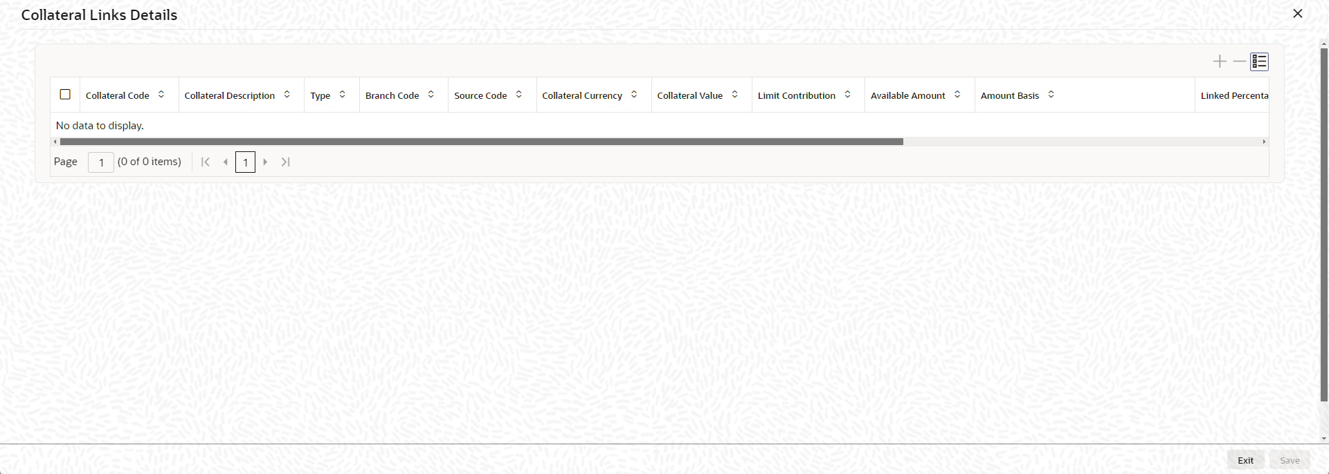

  1. On Facilities Maintenance screen, click the Collateral Links tab.
    The Collateral Links Details screen is displayed.
    Figure 2-15 Collateral Links Details
    Table 2-61 Collateral Links Details - Field Description
    Field Description
    Collateral Code Click the Search icon and select the collateral code for linking with the facility.
    Collateral Description Displays the description based on the collateral code selected.
    Type Displays the type based on the collateral code selected.
    Branch Code Displays the branch based on the collateral code is linked.
    Source Code Displays the code of the source system where the collateral is maintained in the external system.
    Collateral Currency Displays the currency based on the collateral code selected.
    Collateral Value Displays the total value of the collateral code.
    Limit Contribution The system calculates the Limit Contribution by reducing collateral value to the extend of haircut percentage.
    Available Amount Displays the available amount of the collateral linked.
    Amount Basis Select the amount basis for linking the collateral. The option available are:
    • Percentage
    • Amount
    If Percentage is selected, then the system allows you to enter the percentage only and not the Linked Amount. The Linked Amount is appropriately calculated by the system and it is not editable. The value of the percentage must be from range 0 to 100.
    If Amount is selected, then the system allows you to enter the amount only and not percentage. When amount is entered, the system appropriately calculates the percentage. Ensure to maintain amount in positive.
    User can modify the linkage at facility level from percentage to amount and vice-versa.
    The system ensures that total value of collateral linked to one or multiple facilities is not more than limit contribution.
    Linked Percentage Specify the percentage of limit contribution to be linked with the facility, if Amount Basis is selected as Percentage.
    Linked Amount Specify the collateral amount out of available amount to be linked with the facility, if Amount Basis is selected as Amount.
    If the Amount Basis is selected as Percentage, the Linked Amount will get changed whenever the collateral revaluation happens as a part of batch process.
    Facility Currency Specify the currency for the facility.
    Linked Amount Facility Currency The collateral linked amount is converted to facility currency and displayed.
    Order Number Specify the order for collateral utilization. This is optional. If multiple collaterals are linked to the facility, the utilization will happen in the mentioned order.
    Delinking of collateral is allowed only if the collateral amount is already not utilized/blocked. However, if the utilization / block is only to the extend of few linked collaterals, you can delink a particular collateral after changing the order of utilization of the collateral which you want to delink to the least order.
    • For a DP backed facility, linked collaterals value will continue to get updated in the facility main screen as Collateral Amount, but this will not impact the effective line amount since the effective line amount basis will always be Min (Limit Amount, DP Amount).
    • Collaterals of all types (including Inventory and Account Receivables) can be linked to a DP backed facility.
    • For more information on drawing power, refer Drawing Power Based Facility.
  2. Click Save to navigate to the Facilities Maintenance screen.
