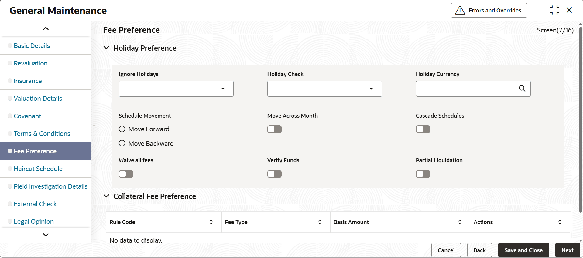

3.12.1.6 Fee Preference
This topic provides systematic instructions about fee preferences.
  1. To enable the Fee Preference section, attach the class code in Basic Maintennace screen.
    The Fee Preferences screen displays.
    For more informatio on fields, refer to the field description table below.
    Table 3-44 Fee Preference
    Field Description
    Holiday Preference This section gets populated based on the attached fee class in the facility. User can change any of the defaulted parameters.
    Ignore Holidays Select the options from the drop-down list. The available options are:
    • Yes: where the holiday treatment is not applied to calculate the next fee liquidation date.
    • No: to validate the holiday preferences settings.
    Holiday Check If holiday treatment is applicable, then you can select Local, Currency or Both options.
    Local refers to Branch Holiday Maintenance. Currency refers to the Currency Holiday Maintenance.
    If Both is selected and either, Branch or Currency is holiday (on fee liquidation date), then holiday processing setting is considered.
    Holiday Currency Click the Search icon and select the holiday currency from the list, if holiday check is maintained as Currency or Both.
    If holiday check is maintained as Currency or Both then you should mention the currency code to referred in ‘Currency Holiday Maintenance’.
    Schedule Movement Select the schedule movement. The available options are:
    • Move Forward: In case calculated next reval date is holiday, then date must be moved forward. In this scenario, next reval date moves to 1st September which is next working date.
    • Move Backward: In case calculated next reval date is holiday, then date must be moved backward. In this scenario, next reval date moves to 30th August which is previous working date.
    Move Across Month
    Switch to On to move the date to next month.
    Switch to Off to avoid moving the date to next month. . This flag should be read in conjunction to Move Forward or Move Backward option..
    Cascade Schedules
    Switch to On to calculate the next fee liquidation date based on the previous schedule date (due to the holiday processing) instead of the original start date.
    Switch to Off to avoid calculate the next date fee liquidation datebased on the previous schedule date (due to the holiday processing) and revert to the original start date.If fee liquidation date for one of the fee liquidation cycles is changed based on holiday processing setting and if cascade schedule is selected,future liquidation dates of corresponding fee gets modified as per the newly arrived liquidation date.
    Waive All Fees
    Switch to On to waive all the fees associated with the fee class.
    Switch to Off to include the all fees.
    Verify Funds This is applicable for facility fees which is enabled with ECA. Not applicable for collateral fees.
    Partial Liquidation This is applicable for facility fees which is enabled with ECA. Not applicable for collateral fees.
    Collateral Fee Preference When a collateral is created using any fee class, the parameters configured for that fee class will get populated in the collateralMaintenance screen. Some of the populated details can be modifiedat collateral level.
    Rule Code Rule code attached to fee class is defaulted
    Fee Type Displays the fee type - rate/amount from the fee rule.
    Basis Amount
    Basis amount is defaulted from fee class - for collateral related fee rules it is COLLATERAL_VALUE
    SDE SDE which is linked to that fee rule is displayed in this field. For event based fees it will signify the event like COLLATERAL_CREATE whereas for recurring fee rule, it will be COLL_AMT
    Component Type Fee component type – slab/tier defaulted from fee rule maintenance.
    Rate or Amount Fee type – rate or amount is defaulted from fee rule maintenance.
    Liquidation Method Liquidation method – Arrears is applicable for recurring fees and Event based is for collateral event based fees. This is defaulted from fee rule maintenance.
    Liquidation Preference Auto or Manual defaulted from fee class and not editable.
    Start Date Date on which first liquidation to start which is different from the one derived based on frequency which user can specify.
    Start Month Month and date on which first liquidation to start which is different from the one derived based on frequency which user can specify.
    Waived Switch on to waive this specific fee linked to fee class
    External Pricing Required This value is defaulted based on the class selected in Fee andAccounting Class Maintenance screen.
    Month end Liquidation Applicable for facility fee.
    Fee Start Date
    Specify the date from which the fee needs to be calculated. If fee start date is left blank, then Collateral Start Date is defaulted. The fee start date cannot be before collateral Start Date. For backdated collateral, fee starts from the collateral creation date and not from collateral start date
    Fee End Date Specify the date up to which the fee needs to be calculated. This cannot be after collateral end date.
    Account Branch This indicates the branch code of fee funding account. User can either enter the branch code or select the branch code from the adjoining option list..
    Account Number Select the fee funding account of the customer
    Account Currency Currency of the fee funding account selected is defaulted and not editable.
    User Input Fee Amount For fee rule of fee type user input enter the user input fee amount.
    Effective Date Effective date of signified rate/amount for the fee rule to be considered for calculation to be entered
    Add rate/input Enables to add fee structure for different amounts when opted.
    Basis Amount Enter the basis amount up to which a particular rate/amount to be considered. Multiple basis amounts with different rate/amount can be entered which is considered for fee calculation based on component type – slab/tier
    Rate/ Amount Enter the rate or amount under appropriate column to be considered for the basis amount.
  2. Click Save and Close to save the added record. Click Next to navigate to the next data segment.
