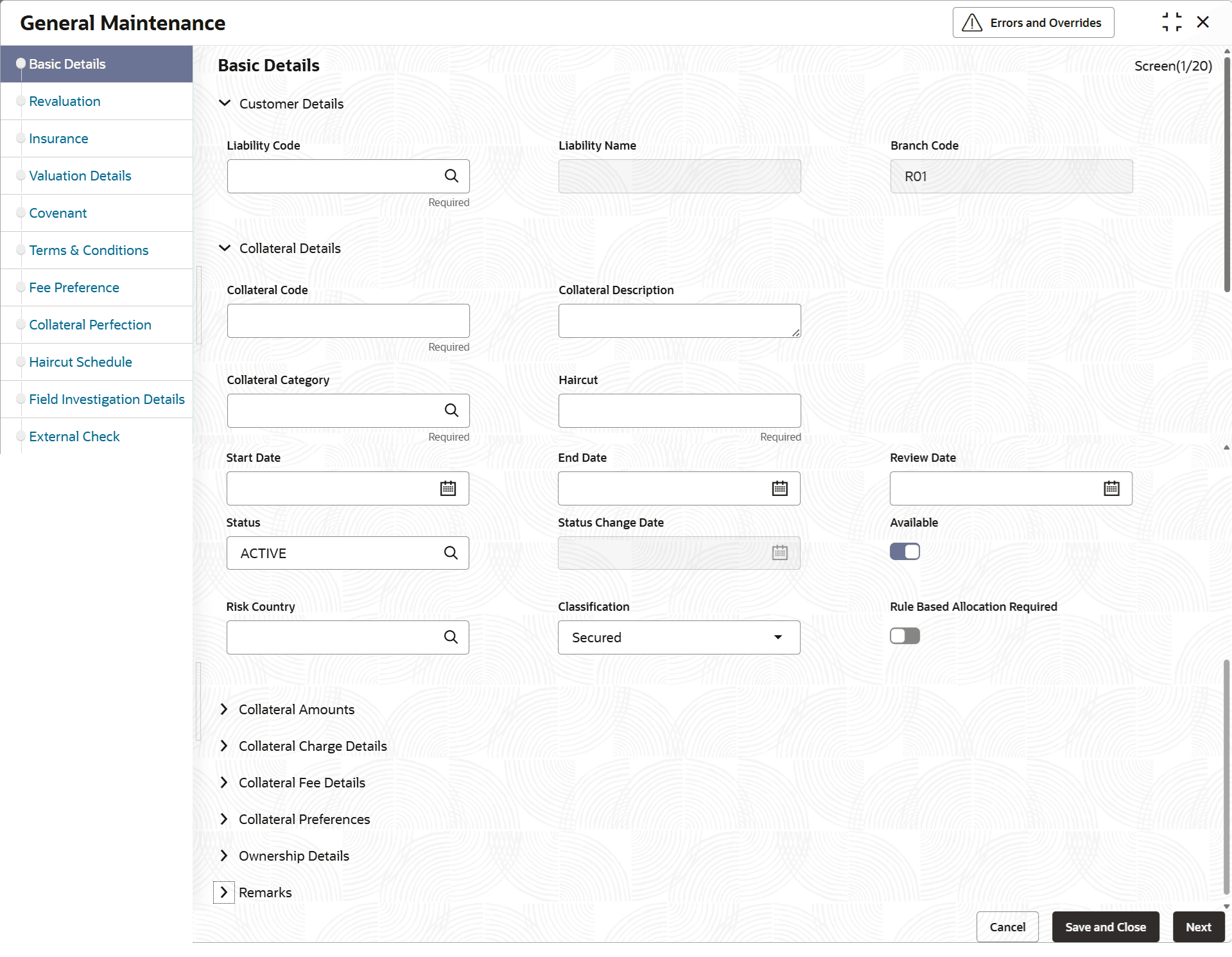

3.12.1 General Maintenance
This topic provides systematic instructions about general collateral maintenance.
- From Menu, select Limits and Collaterals. Under Limits and Collaterals, select Collaterals.
- Under Collaterals, select Maintenances. Under Maintenance, select Collateral Types.
- Under Collateral Types, select General. Under General,
Select General MaintenanceThe General Maintenance screen is displayed.
- On Collaterals Maintenance screen, specify the
fields.For more information on fields, refer to the field description table.
Table 3-29 Collaterals Maintenance - Field Description
Field Description Basic Details This section displays the basic details. Liability Code Click the
icon and select the liability code from the list.
Collaterals are created under the Liability.
Liability Name This field gets defaulted from the liability code. Branch Code Defaults the logged in user;s branch where collateral is created Collateral Code Specify the Collateral Code here. A maximum of 20 alphanumeric characters are allowed in this field. Each Collateral code should be unique.
