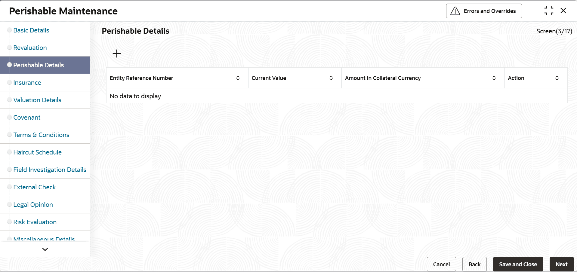

  1. On Home screen select Limits and Collaterals. Under Limits and Collaterals, select Collaterals. Under Collaterals, select Maintenances.
  2. Under Maintenances, select Collateral Types. Under Collateral Types, select Perishables.
  3. Under Perishables, select Perishable Maintenance.
    The Perishables Details screen is displayed.
    Figure 3-158 Perishable Details
    Click
    Add
    icon.
    The Perishable Details screen displays.

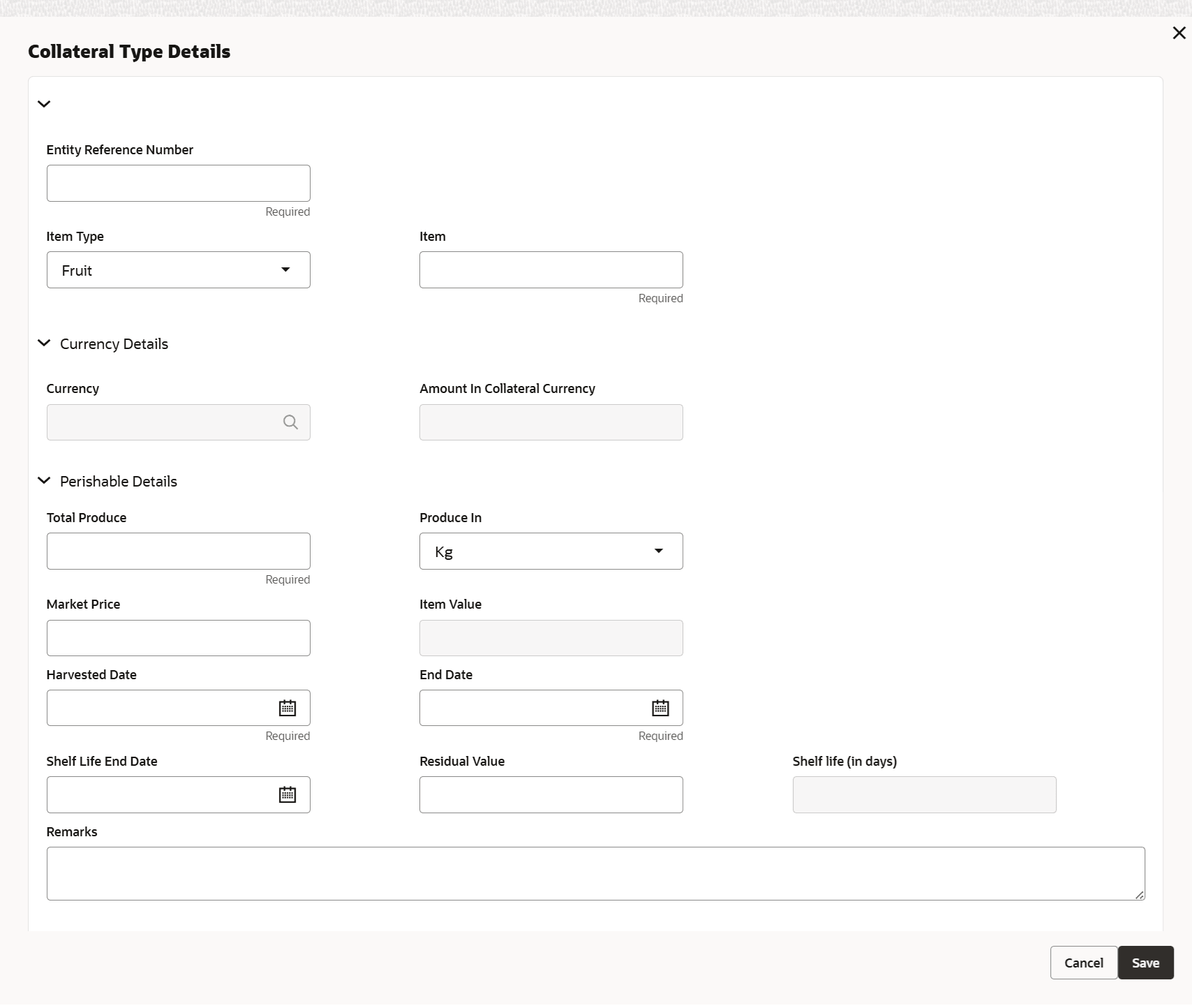

    Figure 3-159 Perishables Details
    Table 3-114 Field Description
    Fields Description
    Entity Reference Number Specify the reference number of the perishable collateral record.
    This has to be unique across multiple records added for the same collateral
    Entity reference number will be shown against reference number in applicable sub systems to attach sub system record to a child collateral
    Item Type Select the item type from the drop down list. The available options are:
    • Fruit
    • Vegetable
    • Flower
    Item Specify the item details.
    Currency If the collateral being is enabled for manual revaluation, then click the Search icon and select the currency from the option list. However, in case collateral being is enabled for external revaluation, currency gets populated based on the security code selected.
    Amount In Collateral Currency Wherever perishables currency is different from collateral currency, perishables in the collateral is converted to collateral currency as per the Exchange rate configured at Exchange Rate maintenance Screen and collateral value is updated.
    Table 3-115 Perishables Details - Field Description
    Field Description
    Total Produce Specify the total no of products produced.
    Produce In Specify the measurement type like Kilogram, Pound, etc., from the drop down list to be read with total produce value.
    Market Price Specify the market price.
    Item Value Item value is derived considering market price and total produce and displayed.
    Harvested Date Specify harvested date.Harvest date cannot be future dated.
    End Date Specify end date of the perishable record. End date cannot be back dated or current dated.
    Shelf Life (in days) Shelf life (in days) is based on the Harvested date and Shelf life End date.
    Residual Value Residual value is updated as the Collateral value once the Shelf Life End date has been crossed.
    Shelf Life End Date Select the end date of shelf life. Residual value is mandatory when Shelf life End date is provided.
    Remarks Specify remarks, if any.
    Cold storage or warehouse Details
    The storage details of perishables can be updated. You can also enter insurance details for perishables.
    Table 3-116 Cold Storage or Ware house Details
    Fields Description
    Storage Location Specify the storage location details.
    Charges Specify ware house charge.
    Insurance Coverage Specify insurance coverage value for the item stored in ware house.
    Table 3-117 External pricing details - Field Description
    Field Description
    Security Code Select the security code when collateral is enabled for external revaluation
    Security Description Displays the description of the security code selected.
    Market Price code click the Search icon and select market price code applicable for this security code.
    Unit value Unit value is defaulted for the price code selected.
    Number of units Specify the number of units of security being considered for collateral creation.
    Current value Based on unit value and number of units, current value is calculated and displayed.
  4. Click Save to save the record.
