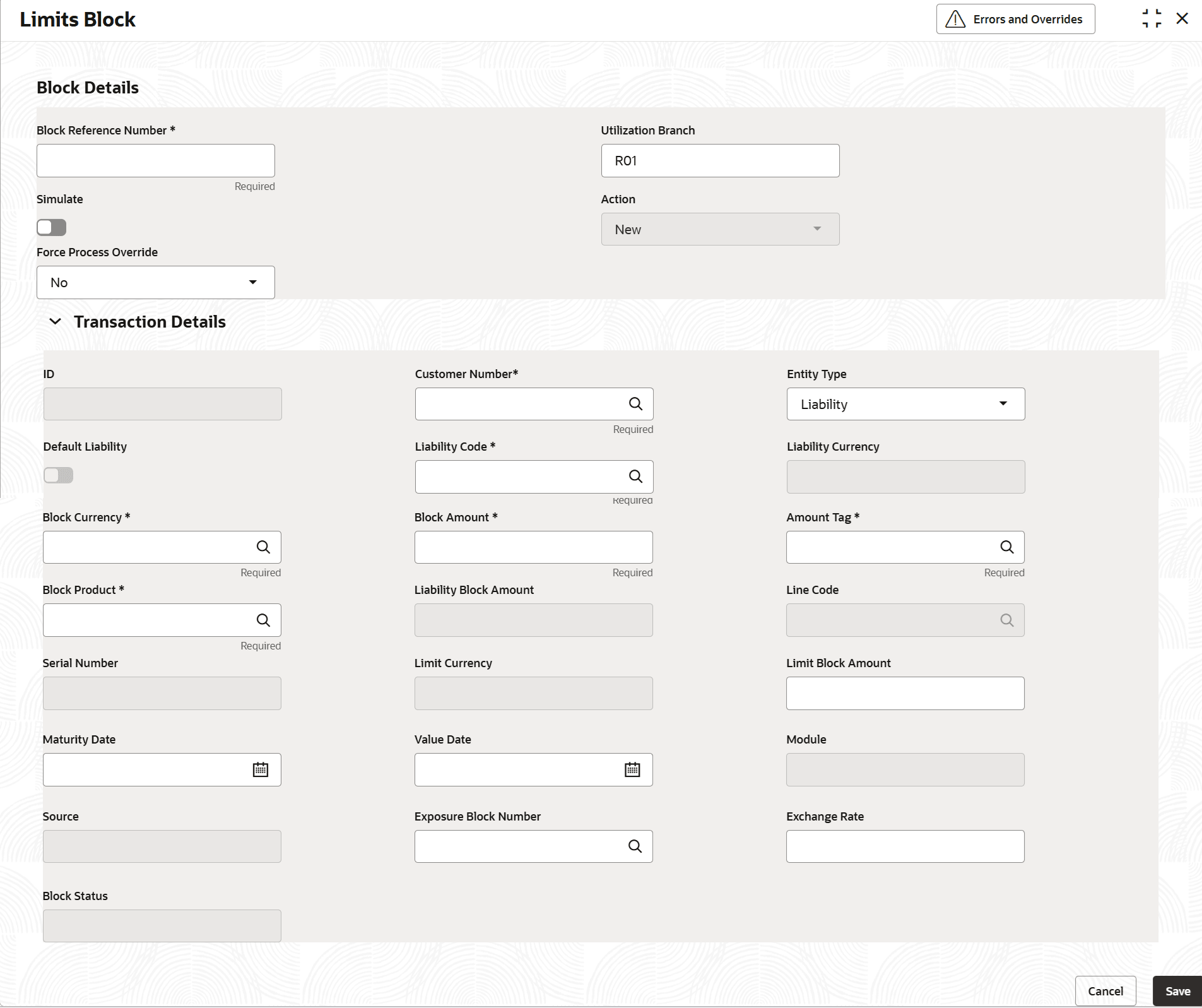

1.2.4.1 Limits/Liability Block
This topic provides systematic instructions about Limits/Liability Block.
The Limits Block screen is a screen for capturing Block request specific to liabilities and facilities in Enterprise Limits System.
  1. On Home screen, select Limits and Collaterals. Under Limits and Collaterals, select Limits.
  2. Under Limits select Transactions. Under Transactions, select Limits Block.
    The Limits Block screen is displayed.
  3. On Limit Block screen, specify the fields.
    Table 1-85 Limit Block - Field Description
    Field Description
    Block Reference Number Specify the unique number which is to be assigned for every block to be created. Usually, Block reference Number is the actual contract number in external system which is placing the Block.
    Simulate Switch to Onto indicate that the details for the transaction being entered should be used only for simulation and not stored permanently within the system. After a successful simulation of a transaction, the system displays the utilized amount for liability and ,facility.
    Force Process Override This is for checking the error type of the error codes raised during transaction - online or batch. Possible values are N (Online) and B (Batch).
    Block Branch Branch code is displayed here. It indicates the transaction branch code.

    ID Indicates the transaction ID. This is auto generated by the system.
    Customer Number Specify the Customer Number of the contract blocking the facility. Customer Number entered should be valid Customer Number in Oracle Banking ELCM system.
    Entity Type Select the limit type from the drop down list. The options available are:
    • Liability
    • Facility
    Default Liability Switch to On to enable this parameter. When a customer number is selected from drop-down list, default liability toggle is enabled by default and Liability Code column shows the liability to which this customer is linked as default..
    Switch to disable this parameter. If a customer is linked to multiple liabilities and blocking transaction needs to consider the entity belonging to a liability which is not default, then default liability needs to be disabled, and liability number can be selected from drop- down list against this field. This gets disabled automatically when you select the non-default liability of the customer.
    Liability Code Click the Search icon and select the liability code from the list. . All liabilities (default and non-default) to which a customer is linked are displayed
    Liability Currency Displays the currency of the selected liability code.
    Block Currency Click the Search icon and select the currency for the Block transaction. The adjoining option list contains all the currencies maintained in the system
    Block Amount Specify the amount for the Block transaction.
    Note: For NRS lines, facility amount can be blocked only to the extent of Available Amount. NRS Available amount will not be considered during facility block transaction.
    Amount Tag Click the Search icon and select the amount tag from the list. The Amount Tag entered in Amount Tag Maintenance screen is displayed here. This typically indicates the type of the component of the transaction such as PRINCIPAL AMOUNT.
    Block Product Click the Search icon and select the product for the transaction. This indicates external product code initiating the utilization transaction.
    Line Code Click the Search icon and select the line code to be used for the transaction. The adjoining option list contains all the line codes allowed. This option is required when you select Entity Type as ‘Facility’
    Serial No The Serial Number field is disabled and it gets defaulted from the Facilities Maintenance screen.
    Limit Currency This field displays the limit currency of the entity (Liability or facility)
    Limit Block Amount Specify the amount to be blocked from the entity in limit currency.
    • As part of a cross-currency block transaction, this accepts the block amount in limit currency and uses that directly instead of deriving it based on the block amount in transaction currency and the exchange rate.
    • If the Limit Block Amount is specified, currency revaluation is not applicable for the utilization transaction.
    Block Status Indicates the Block status. The available options are:
    • Active
    • Reverse
    • Liquidated
    Maturity Date Specify the date on which the transaction matures. This is contract attributes sent by external product processors.
    Value Date Specify the value date for the transaction. System supports both current dated and back dated block transactions.
    Module The module from which the transactions are triggered is displayed here. This is typically the associated module of the product processor which initiates the transaction.
    Source Code Indicates the product processor name from where the transaction has been originated. This field will be as part of Header section (Source Code).
    Exposure Block Number Click the Search icon and select the unique number for the block you are creating. The system does not allow you to modify this number after authorization.
    Exchange Rate Specify the Exchange Rate for cross currency Block transaction. The Block amount for the Limit Entities Facility, Pool, Liability, and Exposure linked to liability and facility will be calculated in the mentioned Block currency directly using this exchange rate instead of the exchange rate mentioned in Config Service.
    If Block amount is in limit currency and the Exchange Rate is not provided as a part of Block, then the system will calculate the Exchange Rate with the Block amount in transaction currency and the Block amount in limit currency.
    Note: The exchange rate mentioned in Facility Block will be used only for the calculation of direct limit entities Block. For more details, refer to Common User Guide in Exchange Rate topic in Cross Currency Behaviour section.
  4. Click Save to save the record.
