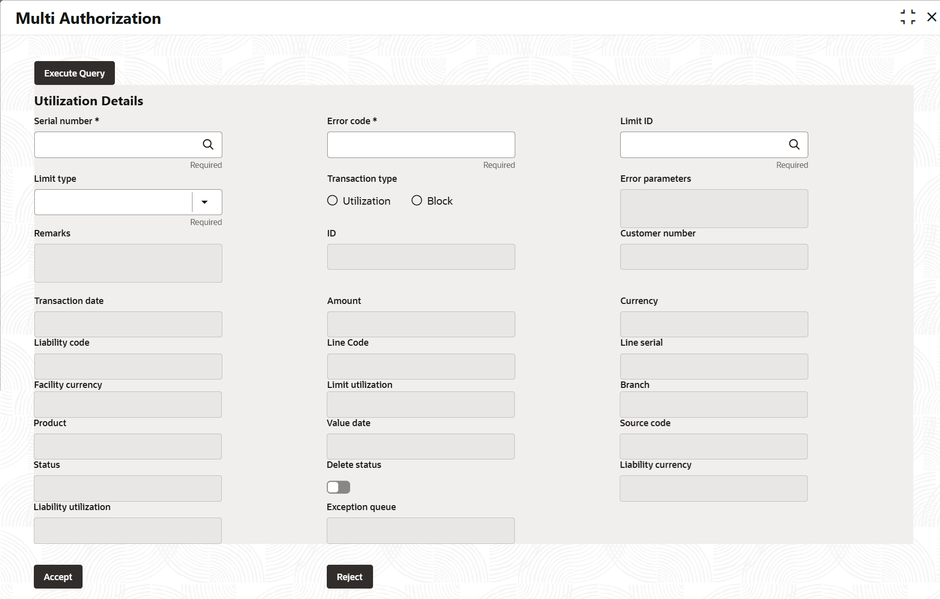

  1. On Home screen, select Limits and Collaterals. Under Limits and Collaterals, select Limits.
  2. Under Limits, select Transactions. Under Transactions, select Multi Authorization.
    The Multi Authorization screen is displayed.
    Figure 1-76 Multi Authorization Maintenance
  3. On Multi Authorization Maintenance screen, specify the fields.
    All the fields available in the Multi Authorization Maintenance screen are display only fields. Only Accept or Reject for authorization of the breached transaction is allowed.
