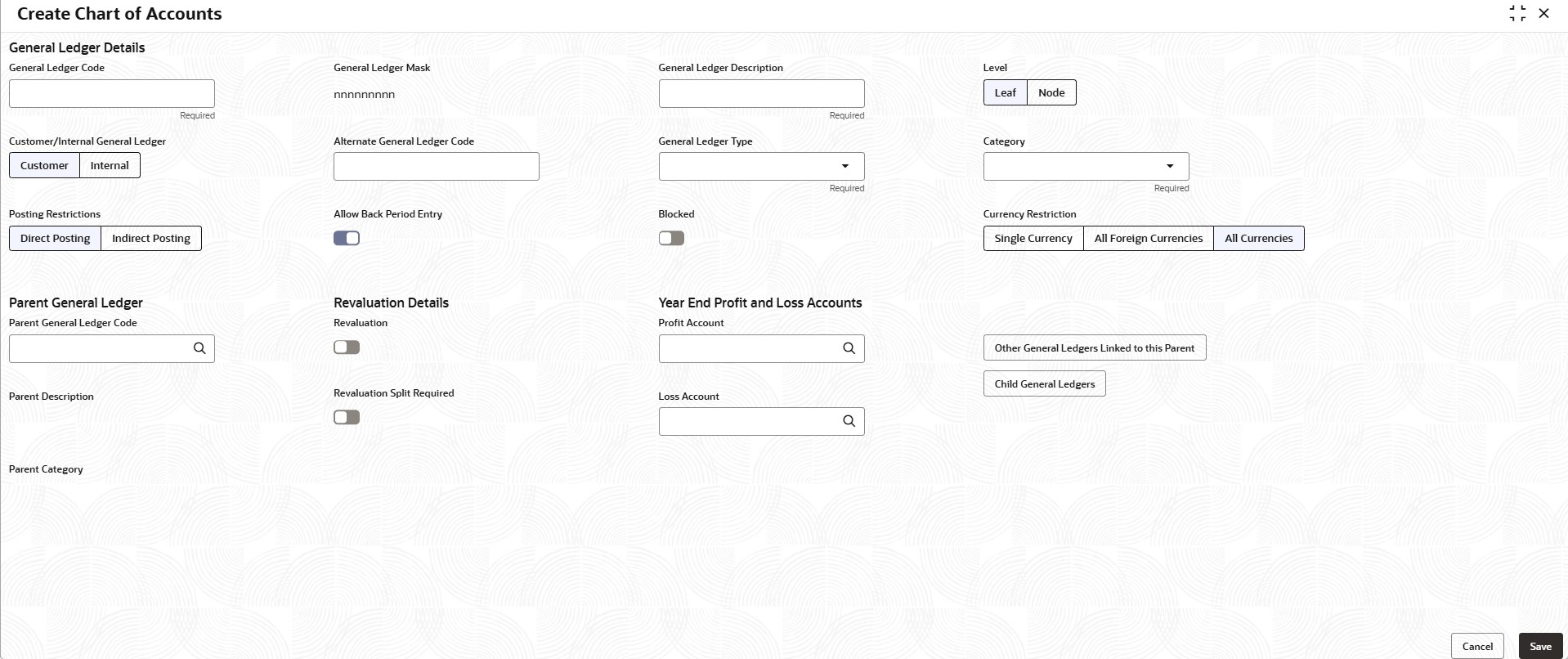

  1. On the homepage, click Menu and click Operational Ledger, and then click Maintenance. Under Maintenance, click Chart of Accounts, and then click Create Chart of Accounts.
    The Create Chart of Accounts screen displays.
  2. Specify the details, for more information on fields, refer to the field description table.

  3. Select Create Chart of Accounts.
  4. Enter the required General Ledger details.
  5. Save the record.
  6. Authorize the Chart of Accounts record.
