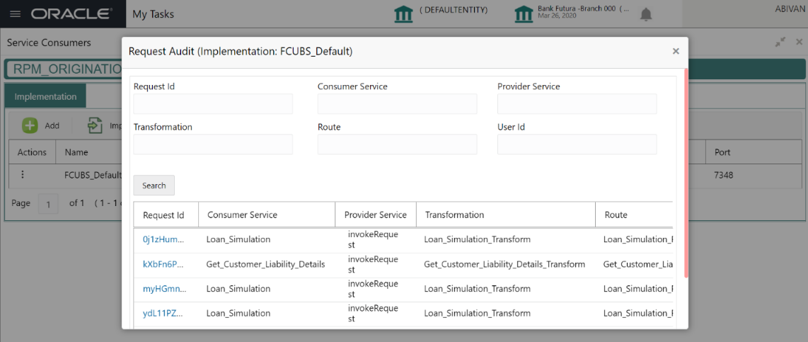

    4. From the Actions, click on Request Audit.
      Figure 3-12 Service Consumer
      This figure displays the Service Consumer.
    5. Check the latest Transformation for which you have performed the operation.
      Figure 3-13 Request Audit
      This figure displays the Request Audit.
    6. Click on the Request ID and check the Provider Response to check for any errors.

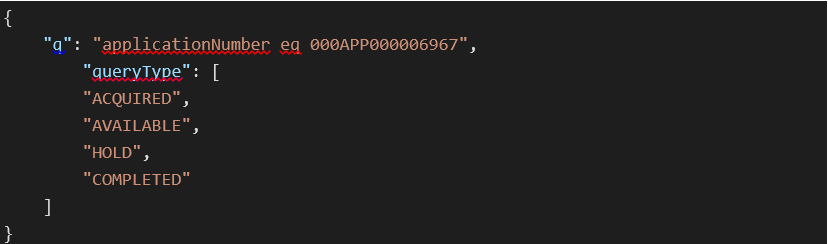

  2. If there is no Oracle Banking Routing Hub call but, still Host call is failing (especially for Account Creation), then failure might be in the workflow task level. In order to debug this scenario, follow the below steps:
    1. Using the Application Number, call the plato-orch-service search API (API details given below) using Postman.
      API Url: http://whf00dtm.in.oracle.com:7011/plato-orch-service/api/v1/extn/custom-actions/queries/tasks?offset=0&limit=100
      Figure 3-14 Body
      This figure displays the Body.
