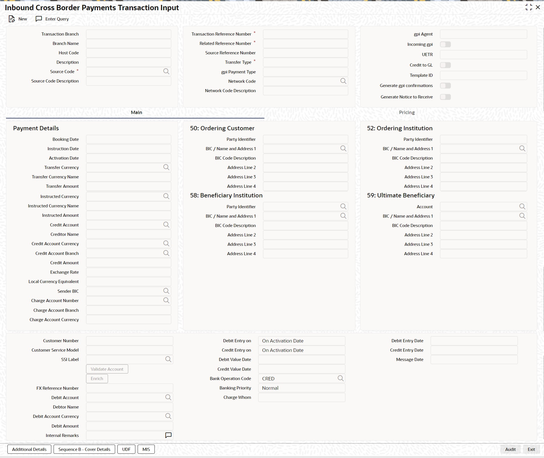

4.1.1 Inbound Cross Border Payments Transaction Input
The Inbound Cross Border Payments Transaction Input screen allows users to book an Inbound SWIFT payment by providing input for the payment transaction.
  1. On Homepage, specify PXDITONL in the text box, and click next arrow.
    Inbound Cross Border Payments Transaction Input screen is displayed.
    Figure 4-1 Inbound Cross Border Payments Transaction Input
  2. Click New button on the Application toolbar.
  3. On Inbound Cross Border Payments Transaction Input screen, specify the fields.
    For more information on fields, refer to the field description below:
