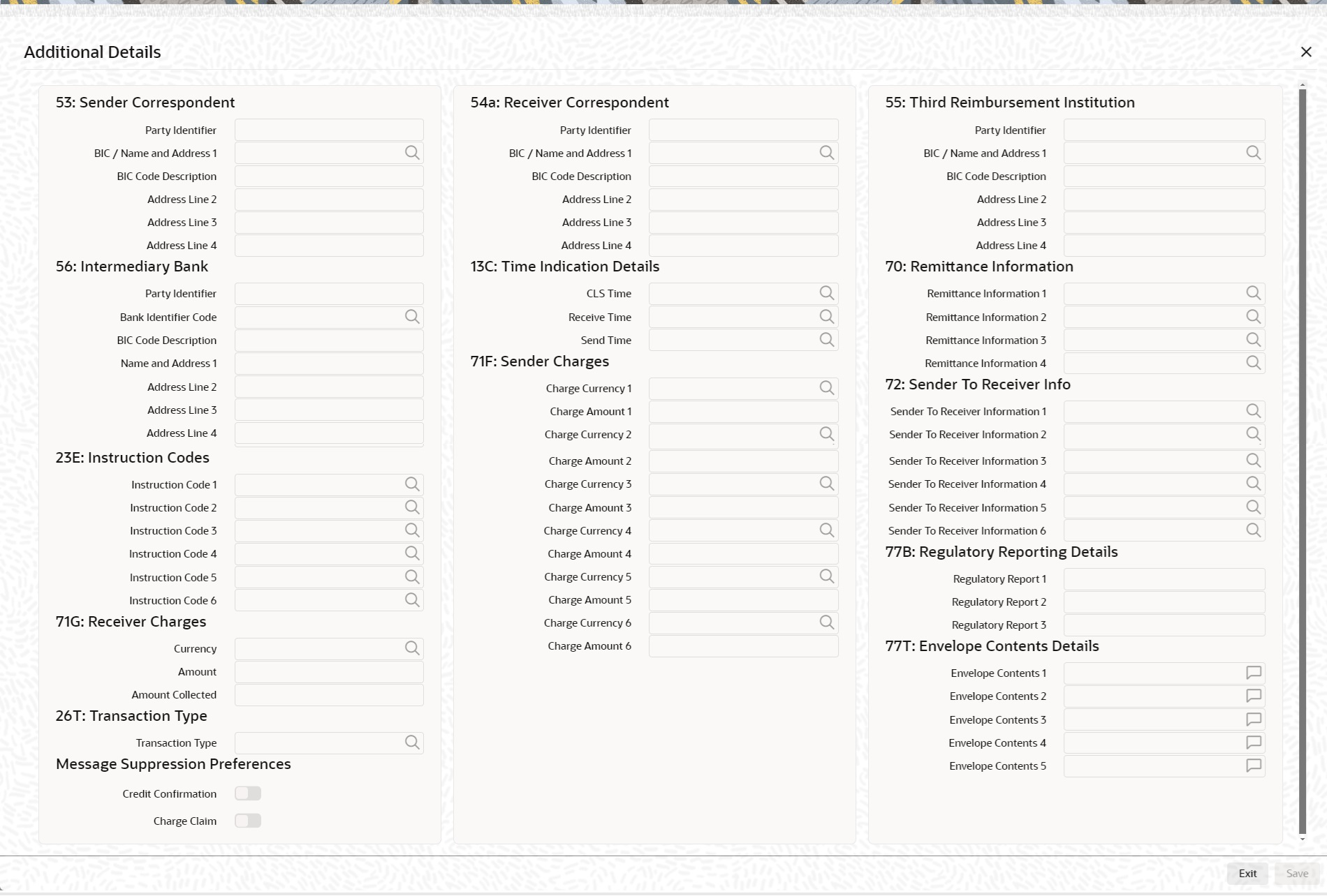

4.1.1.3 Additional Details Button
The Additional Details button allows users to capture additional information and view field values set by the system for the transaction.
  1. Click the Additional Details button at the bottom of the Inbound Cross Border Payments Transaction Input screen.
    The Additional Details sub-screen is displayed.
    Figure 4-4 Inbound Cross Border Payments Transaction Input_Additional Details Button
  2. On Additional Details button, specify the fields.
    For more information on fields, refer to the field description below:
