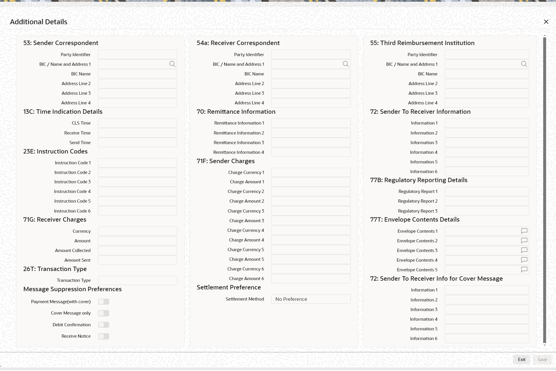

3.1.1.3 Additional Details
  1. Click the Additional Details button at the bottom of the Outbound Cross Border Payments Transaction Input screen.
    The Additional Details sub-screen is displayed.
    Figure 3-5 Outbound Cross Border Payments Transaction Input_Additional Details
  2. On Additional Details button, specify the fields.
    For more information on fields, refer to the field description below:
    Table 3-4 Outbound Cross Border Payments Transaction Input_Additional Details - Field Description
    Field Description
