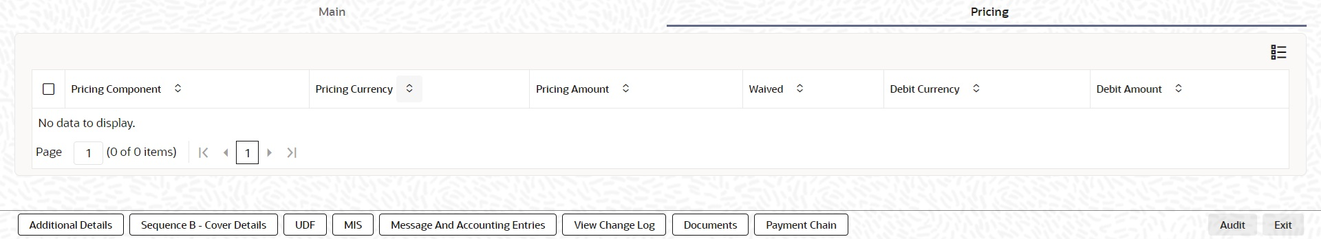

3.1.1.2 Pricing Tab
User can view the charge amount computed by the system for each of the Pricing components of the Pricing code linked to the network code of the transaction.
  1. Click the Pricing tab and view the pricing details.
  2. For the Transaction initiated, system displays the fees/tax charged in this section.
  3. On Pricing screen, specify the fields.
    Table 10-3 Pricing
    Field Description
    Pricing Component System displays each Pricing component of the Pricing code from the Pricing Code maintenance.
    Pricing Currency System defaults the pricing currency of the component from the Pricing code maintenance.
    Pricing Amount System displays the calculated Charge amount for each Pricing component of the Pricing code.
    Waived System displays if charges for any Pricing component are waived in the Pricing maintenance.
    Debit Currency System displays the currency of the Charge account to be debited for the charges.
    Debit Amount System displays the Charge amount for each Pricing component debited to the charge account in Debit currency. If the Pricing currency is different from the Debit currency the calculated charges are converted to the Debit currency and populated in this field.

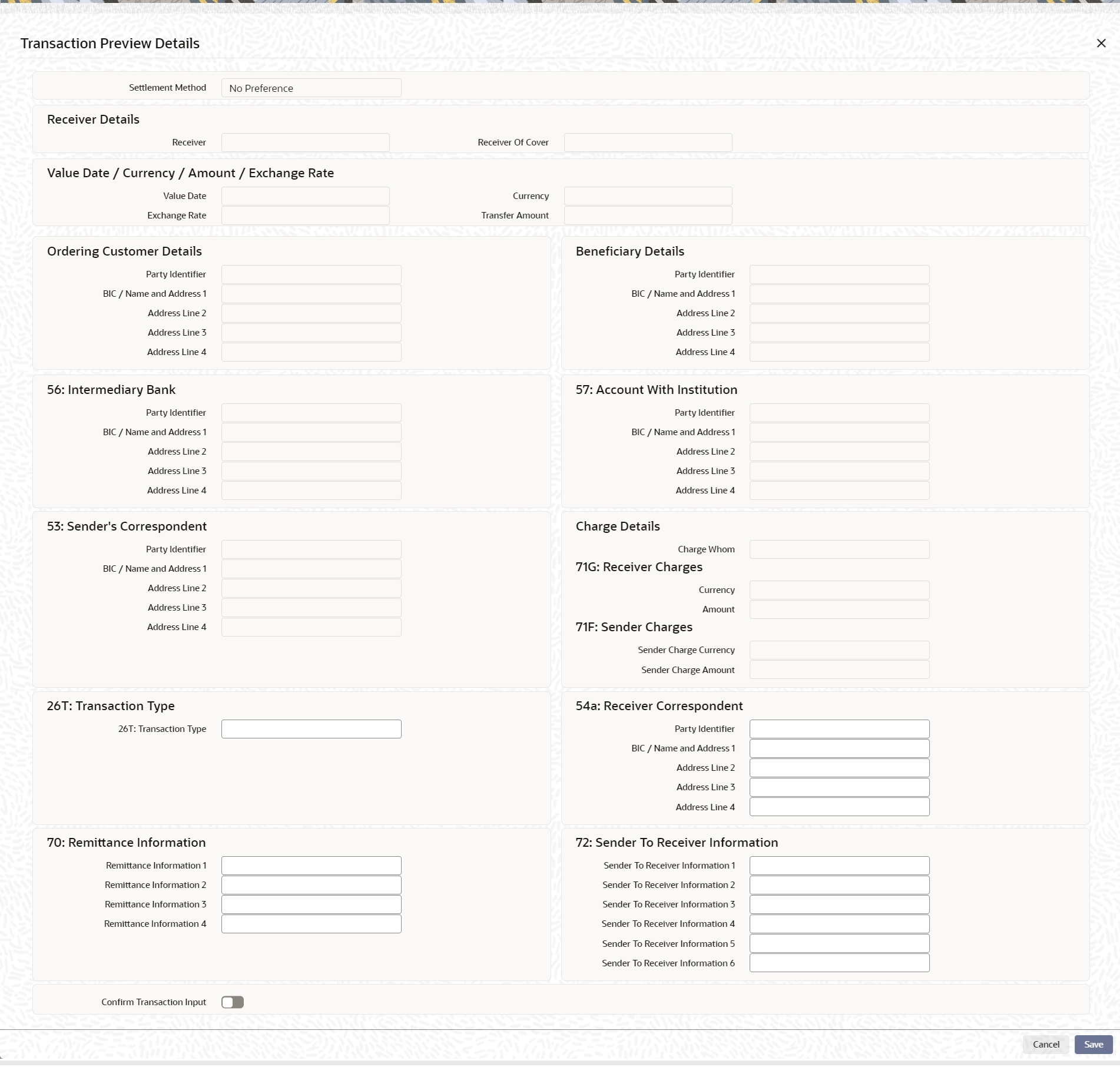

    Transaction Preview Details
    On clicking of this button, below sub screen is launched.
    Figure 10-4 Transaction Preview Details
    This sub screen displays below fields:
    • Settlement Method
      - Displaying Settlement Method : Serial / Cover
    • Receiver Details
      • Receiver & Receiver Description
      • Receiver of Cover & Receiver of Cover Description
    • Value Date / Currency / Amount / Exchange Rate
      • Value Date (32A Date)
      • Transfer Currency
      • Transfer Amount
      • Exchange Rate
    • Ordering Customer Details
      • For MT 103 - Field 50 : Ordering Customer details - Party Identifier / BIC / Name / Address Line 1 to 4
      • For MT 202 - Field 52 : Ordering Institution details - Party Identifier / BIC / Name / Address Line 1 to 4
    • Beneficiary Details
      • For MT 103 - Field 59 : Beneficiary details - Party Identifier / BIC / Name / Address Line 1 to 4
      • For MT 202 - Field 58 : Beneficiary Institution details - Party Identifier / BIC / Name / Address Line 1 to 4
    • Intermediary Bank Details - Field 56 : Intermediary Bank
    • Account with Institution Details - Field 57 : AWI
    • Sender's Correspondent Details - Field 53
    • Charge Details
      • Charge Whom
      • Receiver's charges
      • Sender's charges (Our charges)
    • Confirm Transaction Input - A checkbox field
      - This field is editable only if Transaction Preview is required.
    On clicking of OK, then the transaction preview validations is done.
