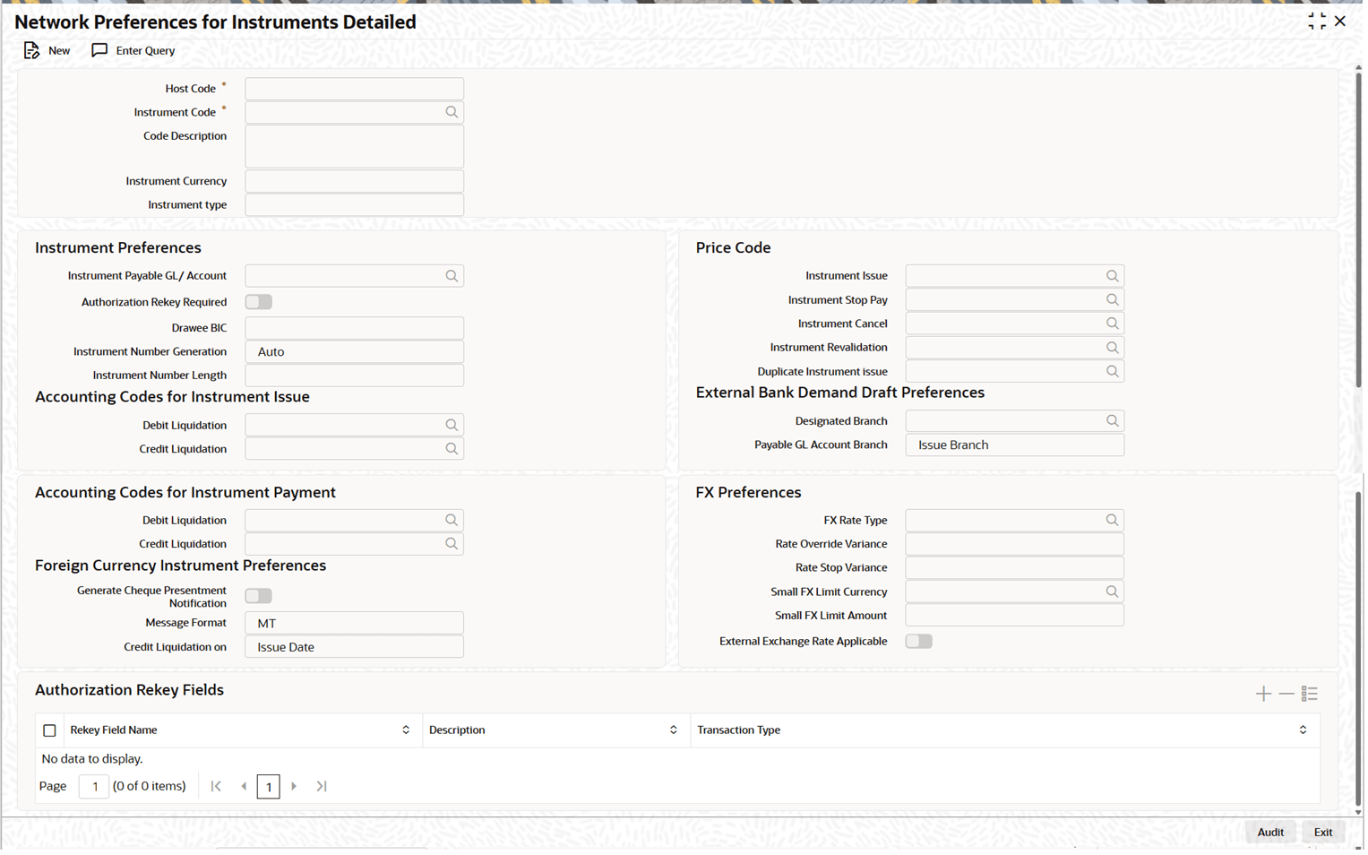

2.1.3 Network Preferences for Instrument Detailed
- On Homepage, specify PIDINPRF in the text box, and click
next arrow.Network Preferences for Instrument Detailed screen is displayed.
Figure 2-5 Network Preferences for Instrument Detailed
Description of "Figure 2-5 Network Preferences for Instrument Detailed" - Click the New button on the Application toolbar.
- On Network Preferences for Instrument Detailed screen,
specify the fields.
Table 2-3 Network Preferences for Instrument Detailed - Field Description
