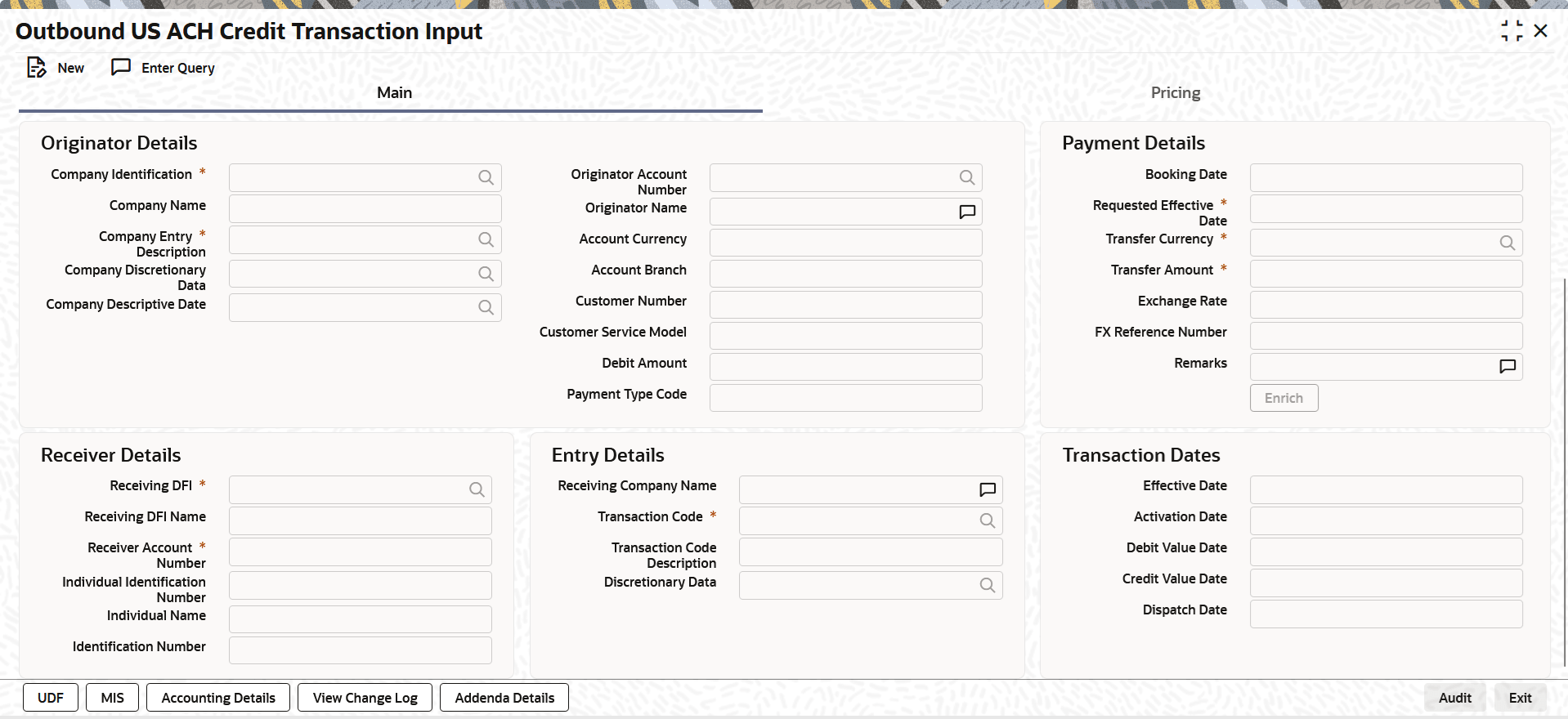

1.2.1.1 Main Tab
This topic explains the Main tab of the Outbound US ACH Credit Transaction Input screen.
  1. Select the Main tab in the main screen.
    The Main details are displayed.
    Figure 1-27 Outbound US ACH Credit Transaction Input_Main Tab
  2. On Main tab, specify the fields.
    For more information about the fields, refer to field description table.
    Table 1-24 Outbound US ACH Credit Transaction Input_Main Tab - Field Description
