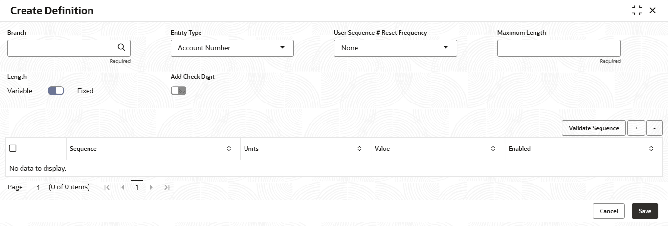

    The Create Definition screen is displayed.
  3. Specify the fields on Create Definition screen.

    Table 2-3 Create Definition - Field Description
    Field Description
    Branch Click Searchicon and select the branch from the list. The value *.* represents Auto Number maintenance, which can be commonly referred by all the branches.
    The maintenance can be performed for a specific branch with branch Code value also other than *.* (Common maintenance for all branches ).
    Entity Type Specify the type from the drop-down list.
    The available options are:
    • Account Number
    • Quote ID
    User Sequence # Reset Frequency This field refers to the frequency at which system will reset the User Sequence, if it is part of auto number generation logic. Select the frequency from the drop-down list.
    • None
    • Daily
    • Weekly
    • Monthly
    • Quarterly
    • Semi-Annual
    • Annual
    Maximum Length This field indicates the maximum length of the entity number that system should generate. Specify the maximum length. For entity type account number maximum length allowed is 36.
    Length This field refers to whether the length of sequence number generated will be variable or fixed length.
    • Variable
    • Fixed
    For both the above options, the length of entity reference number can be maximum upto Maximum Length. If it is fixed and total length of reference number is less than the maximum length, then zeroes are prefixed to system sequence number. If it is variable, then zeroes are not prefixed to system sequence number.
    Add Check Digit
    Switch ON to add the check digit. Refers to whether the system should add a check digit to the end of the reference number.
    Switch OFF to avoid adding the check digit.
    Validate Sequence Click on Validate Sequence button to view the sample reference number that will get generated as per the format configuration done
    Sequence Specify the sequence in which the fields of reference number will be ordered while generating the same. For example, lets say first field in the sequence is a constant, say LN and the second field is branch code, followed by third field product code, then generated reference number will be always having LN+ branch code value+Product code value in that order.
    Units This refers to type or nature of reference fields like constant or viariable or julian date that forms the components of reference number generation logic.
    • Constant - Constant value mentioned will be used as it is in number generation logic.
    • Record Creation Year/Month(YYYYMM) - This refers to the year and month of reference number genration. The parameter's length is 6 (eg) 201401 for Jan 2014.
    • Record Creation Year(YYYY) - This refers to the year of reference number generation. The parameter's length is 4. eg. 2014.
    • Record Creation Year(YY) - -This refers to the year of reference number generation. The parameter's length is 2. eg. 14.
    • Record Creation Month(MM) - This refers to the month of reference number generation.The parameter's length is 2. Eg. 01/02/03 etc.
    • Record Creation Date(DD) - This refers to the date of reference number generation.The parameter's length is 2. Eg. 15 for 15th day of the month.
    • User Sequence Number > Length - The allowed value is integer. The length will be aligned with the user input value. The system should always start the sequence number with 1 and pad it with zeros based on the length specified.
    • Random Number > Length - The allowed value is interger. The length will be aligned with the user input value. The system should generate a random number of this length..
    • System Sequence Number > Length - The allowed value is integer. The length will be aligned with the user input value. The system should produce the sequence number by referring to system sequence and not padding it with zeros..
    • Julian Date - The parameter's length is always 5, where the first two digits are the year's final figures, while the last three digits represent the day of the year.
    • Variable Code - When Units is selected as a variable, the Value field will have a drop-down. The available options are:
      • Branch Code -The system will return the value of the branch code. The length of which is always 3.
      • Product Segment Code - The system will return the value of the product segment code, the length of which is always 4.
    Value Specify the value based on the Units selected.
    Enabled Click on toggle status to enable the parameter to be used in the number generation.
